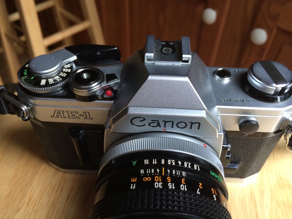

The AE-1 waz a milestone but it's mostly plastic.
Not at all.
The body of the AE-1 is made of a cast-metal frame.
The only plastic parts are the top cap and the tiny, unimportant cover around the lens mount.
A camera I advise any starter to begin with.
The issues I have seen at AE-1's all were not related to the top cap.
But I would not advise to bring this camara to the beach.

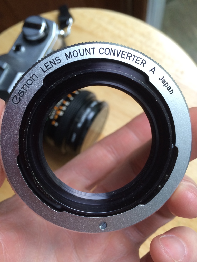

The Canon FD-mount even allows more possibilities for mounting lenses with different mount, as it is one of the shortest built mounts (only surpased by Konica and Miranda SLR's).
Do you get auto-aperture and/or full-aperture metering with any of the adapters? I've got a little lens problem and it'd be great to let my AE-1 enable it.
-NT
I have never been a Nikon fan, but I think the match needle metering of the FE is the nicest of any manual camera. Easy to use and looks good. I was never fond of the "window" aperture display though. It is difficult to see at times.
Do you get auto-aperture and/or full-aperture metering with any of the [FD-Mount] adapters? I've got a little lens problem and it'd be great to let my AE-1 enable it.
There are M42-Adapters (or could be modified) that enable the auto-aperture to function. But then there would be no auto-exposure function.
But with all mountable lenses you could use stepped-down auto-exposure.

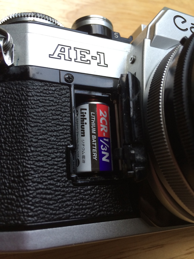

My only complaint is the more obscure battery it takes,
but then the Mamiya 7 takes the same battery so it works out ok for me since I have both.

On the battery issue:
All the Mamiya manual focus medium format cameras/finders that require a battery use the same size battery.
As do a bunch of electronic dog collars :blink:.
So I would venture that the battery situation for an AE-1 is way better than for a lot of other cameras - particularly digital ones!

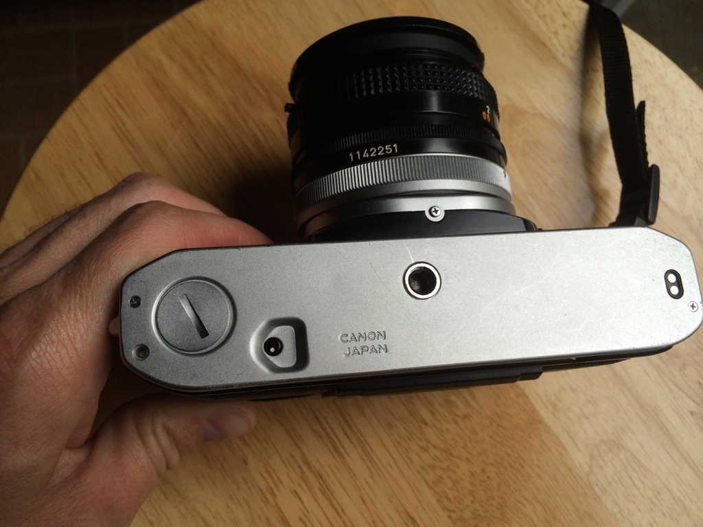

Very true! The battery door on the other hand... Haha, mine actually is ok, just super glued, they have cheap aftermarket ones, it's canon AE-1's only flaw.
