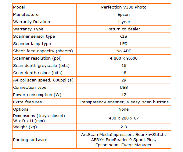

I just picked up an epson V330 for $79 with free shipping. It's in the box with all accessories. Resolution is 4800x9600 which if I'm understanding the Crayon Master's explanation correctly, would be sufficient for up to an 11x14 digital negative enlargement at 400dpi.
No, V330 is probably closer to 1500dpi (true resolution). 4800dpi is sensor resolution and 9600 is probably stepper motor resolution. But since the lens can't resolve more that 1500dpi... 1500dpi is what you get.
Unless you can explain your claim, I'm going with what the factory says.
  • Optical Resolution
    4800 dpi x 9600 dpi
  • Interpolated Resolution
    12800 dpi x 12800 dpi
  • Type
    flatbed scanner
  • Interface Type
    USB 2.0
  • Form Factor
    desktop
  • Input Type
    color
  • Scan Element Type
    CCD
  • Document Size Class
    A4/Letter
  • Max Supported Document Size
    8.5 in x 11.7 in
  • Max H-Document Size
    8.5 m
  • Max V-Document Size
    11.7 m
  • Grayscale Depth
    16-bit (64K gray levels)
  • Grayscale Depth (External)
  • Color Depth
    48-bit color
  • Color Depth (External)
    48-bit color
  • Max H-Optical Resolution
    4800 dpi
  • Max V-Optical Resolution
    9600 dpi
  • Max H-Interpolated Resolution
    12800 dpi
  • Max V-Interpolated Resolution
    12800 dpi
  • Lamp / Light Source Type
    LED
  • Supported Document Type
    film, plain paper, transparencies
  • Document Feeder Type
    manual
  • Scanner Features
    EPSON ReadyScan LED Technology

I already explained why the true resolution is around 1500dpi. Find a test of a consumer Epson/Canon flatbed and you'll soon realise that 4800dpi is a dream. 2500dpi for V800/V700 is pretty much the best you can hope for. 1500dpi for V330/V500/V600. I have a range of scanners (from flatbed to drum scanner) and have tested them so I'm not making this up.
Maybe this review will help you to "not go with what the factory says"?
Great. So I spent $80 on a crap scanner. I knew I should have saved my money and just sent film to a lab.
Because when you say that 1500dpi "is what I get", I hear "you've wasted your money."
