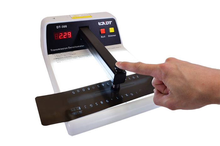

For most film photography, I'd recommend a unit with an illuminated platen and an arm that comes over the top.

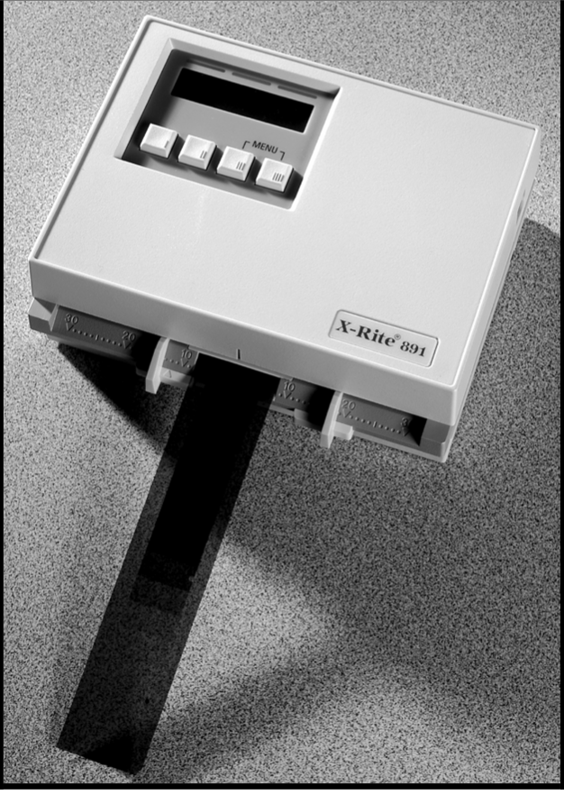

I'd avoid a unit that automatically reads control strips. I have four sensitometers and none of them are really good at making the strips for this machine.
They seem easier to use, for sure...and since I really haven't used them often, "easy to use" is at the top of my list.
That seems like an unnecessary step...and like extra work, as well.
