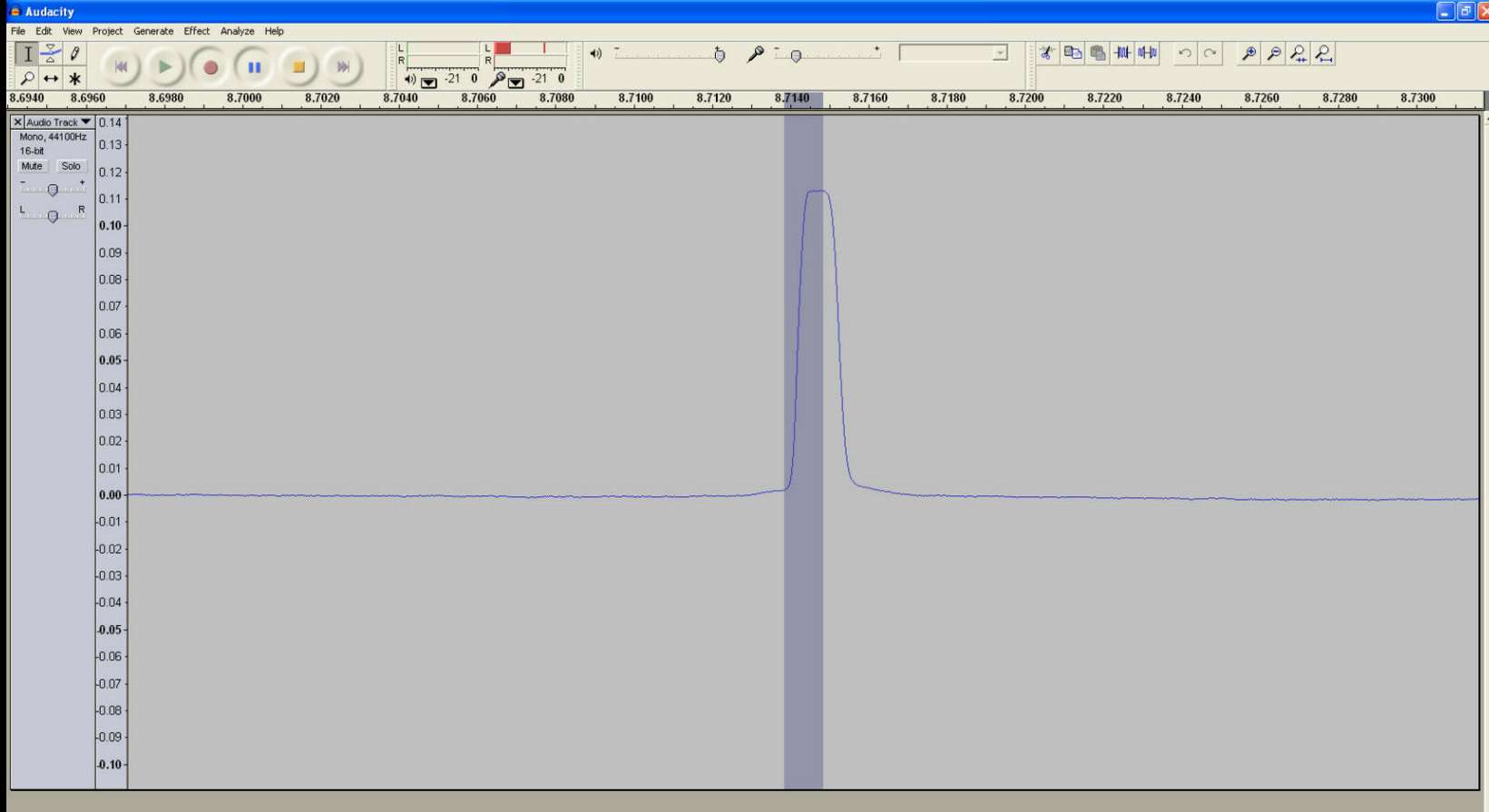

It was the one it has a flat base, but a bare photocell. I hacked it to be used with an usb oscilloscope.
That kind of photocell is intended to be connected in the sound card of a pc, it throws a an electric signal that is interpreed like if it was sound so the signal can be seen with a audio edition software, audacity freeware, typically...
As the audio has a time scale we can check the timing, but if using a regular oscilloscope for electronics (it can also be quite cheap, but I have a good one for other concenrs) then all is quite more convenient. That simple device (can be made for $1 in parts) can deliver accurate measurements, and it also can be quite useful for diagnostics as we see both the openning and closing ramps.
Even the late LF shutter models were sold with a +/-30% tolerance, so 1/30 could be 1/20 or 1/40 and no warranty would had been applied, this is a 1 stop variability, still most of modern units were performing more accurately than that. But our situation today is that service is scarce in many regions, and most of the times shutters have not been serviced for decades. Specially if shooting slides a (cheap, $10 to $90) tester is not a bad idea. With negative film there is not much a problem if overexposing 1/2 to 1 stop as a safety factor, it won't harm... but with slides it's different, a shutter having a single speed that's too slow may burn a Velvia sheet, if it is a 8x10" one then photographer may remember that pitfall for many years !! At least I remember quite well my velvia 4x5" pitfalls.
