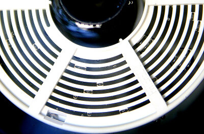

Note the diameter of the airbells is larger than the gaps in a spiral, that's with no film. The issue was worse with a film loaded in the spiral.
Ian
Thanks for the picture, I've always been curious to what those notorious 120 air bells actually looked like on the reels.
