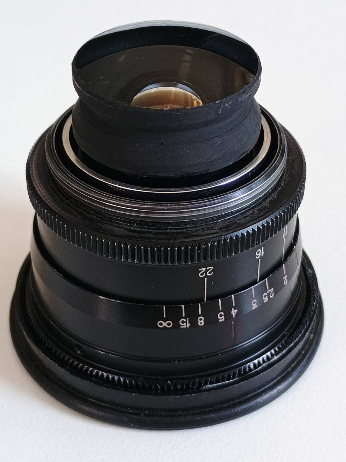

...mine suffers greatly: even at f/8, corners looked terrible.
I had the issue with my J-12, the corners looked bright and blurred. It was caused by light leaks of the big rear lens. The black paint of the lens sides get easily scratched when putting the lens on and off the camera. I repainted the lens sides with black matte blackboard paint and the corners of my images appear much, much better now.

Irreversibly damaged lens of Canon 3.5/100
Jupiter-12 with repainted back lens
