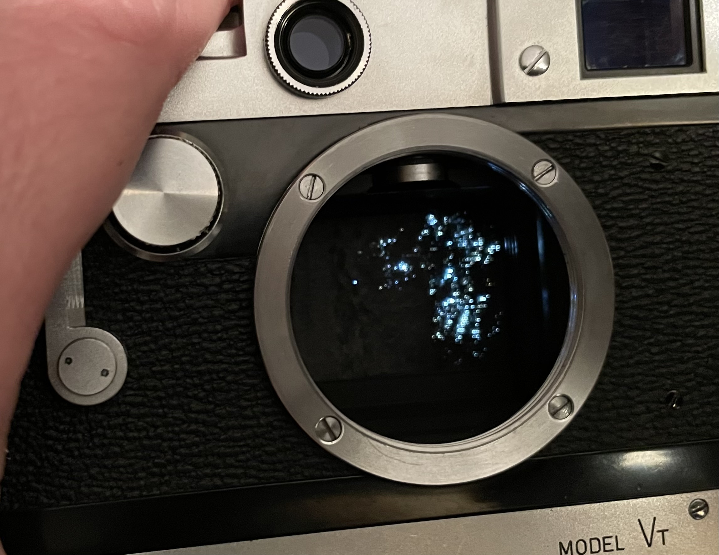

As were talking I'm sitting in front of a VT I just unpacked. Everything looks fine, very nice indeed, but the shutter-curtains are toast. I already got a full refund and I can keep the wreck, so no damage done except the 25% customs-bill.
