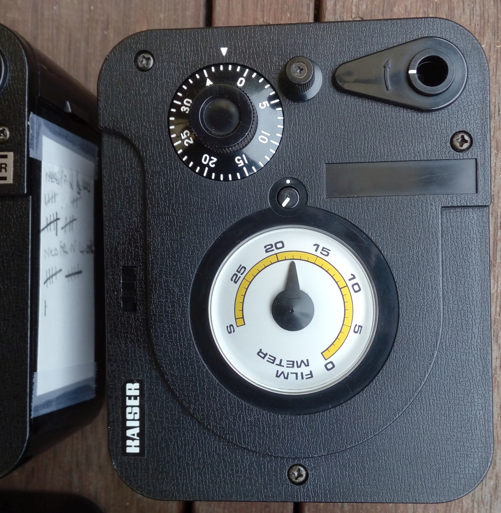

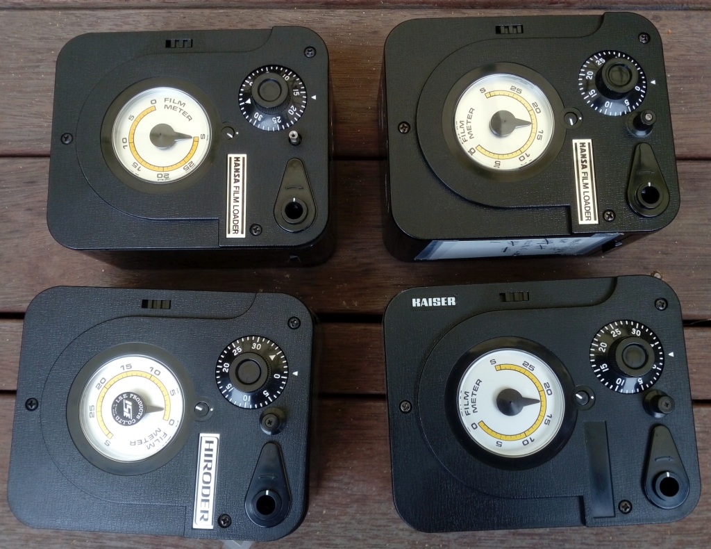

I had the use of a Watson ages ago, it wasn't mine I just borrowed it to bulk load the whole 30m of film onto re-loadable cassettes in one sitting. Nice enough unit. I have also used a couple of other units of similar design, probably identical but with a different name on the outside.
What did float my boat though, was the first time I used a Kaiser bulk film loader. The ease and the ability to load very cleanly. The unit has a film gate which is opened by inserting the wind key. The counter can be set to a few frames before zero, then watched for the amount of frames you wish to load.
I'm not sure if kaiser came up with this design, but there are a myriad of virtually duplicate versions out there at a extremely reduced price compared to the Kaiser unit. I have four of these units, one of which is a Kaiser, the others are for all practical purposes identical to the Kaiser, but their price is about 30% of the Kaiser.
The film dial itself is very handy in letting you know just how far you are through a 30m roll of film.
Mick.

I have the same Kaiser style loaders that Mick Fagan has and I have never had a problem with them. One is Hansa brand and the other is Konica branded, but otherwise identical.
