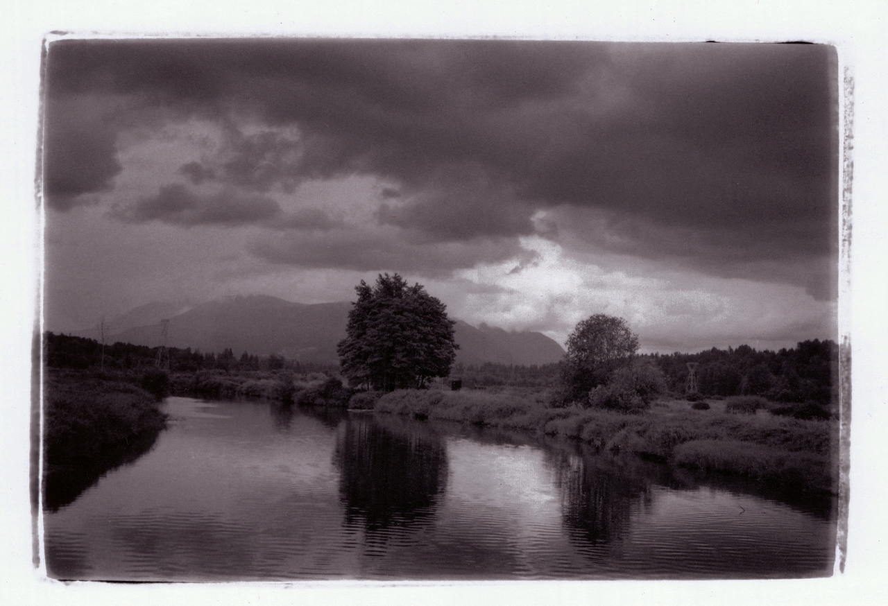

Avoid any RC paper with a neutral or cool image tone. They do not respond well to different chemicals, the image tone will stay almost the same.
I'm afraid this is an over-simplification.
As an example, the modern, neutral tone Ilford RC papers are designed to give very similar tones with a wide variety of developers - that is a design goal. As a result, they respond very little to some toners - selenium toners being a prime example - but quite well to a range of other toners like sepia toner and brown toner. And the Ilford RC Cooltone papers are quite responsive to a few more.
My experience with the Oriental RC papers - the most recent ones which seem to be manufactured by Harman - is that they are more responsive to toners than the Ilford branded papers.
This is a selenium toned postcard on Oriental:
I wasn't quite sure what effects you were seeking, silvercloud2323 but are we covering in our answers what information you are seeking
Thanks
pentaxuser
Seems like I presented outdated knowledge from the past. Many thanks for clarifying and for showing this example. I may try this paper as well!
