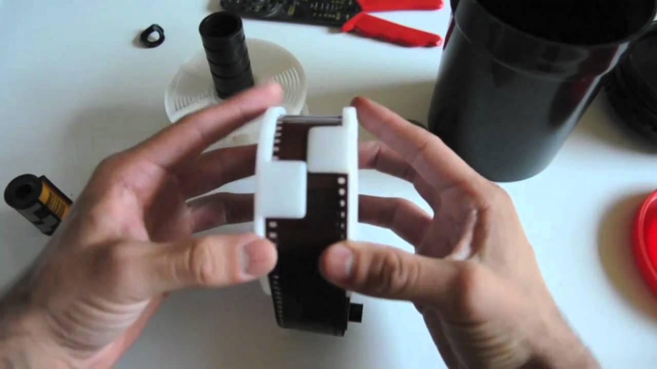

I've been browsing this forum (and elsewhere) a lot and saw all kinds of opinions, which are very mixed. I recently started developing film at home and bought the classical 2-Reel Universal Paterson Tank. I started practicing with the reels and noticed that sometimes they create difficulties. Yes, they were bone dry, brand new. I honestly think I have the technique down very well. When I did my first development I noticed that Ilford Delta 400 film I had went on suuuuper smoothly but the Kodak T-Max 400 started to become more difficult as I was getting further. This brought back some bad memories of failure from a previous attempt further down the line.
Bottom line is... I don't want to take any risks. I value my photos and wouldn't want to ruin a film and lose them. Pulling film out of the Paterson reel can be done with a lot of care but isn't fun. So, I've ordered 2 x 35mm Hewes reels for my Paterson tank which are on the way with FedEx. Are these so much better? Are they foolproof? I read some reviews on B&H (and even here) that some people had trouble with these: basically film rolling on top of another (touching) and losing those shots.
What are some opinions here? Are the Hewes reels better? Is it hard to go wrong with them once you practice enough (in daylight obviously). Is there any technique to check if the film is wound onto the reel correctly? I wouldn't want film overlapping each other and losing shots. Sounds a bit like a nightmare to me. If that can happen so easily, even the Paterson plastic ones sound safer.
If it makes any difference: I plan to develop around 1 roll a week most weeks, and I did read the posts with people saying that they've been using Paterson plastic reels for decades without issues. Even my most trusted and appreciated lab says that they are using Paterson plastic reels in their work. It might be that not all reels are made perfect...
P.S. This is my first post. Thank you in advance and glad to join this lovely community, hoping to learn a lot...
For me the Patersons work very reliably with 35mm film. Did you cut the leader cleanly? Straight, not through sprocket holes, slightly rounded corners, and cut off any strongly bent part of the leader? You can do the trimming with light on if you don't rewind all the way into the cassette. Another point is: move only one side of the reel, keep the other hand still. Use your thumbs (or maybe index fingers if you hold the reel the other way around) to guide the film, keep them on the edges of the film right before it goes in the slit.

The only reels that are "fool proof" are the ones you practice and become proficient with. Even then they aren't 100% fool proof, nothing is. I, and many others, use stainless reels and find them much easier to load than plastic.I started with plastic, switched over half a century ago, no looking back. I do keep a plastic set on the shelf, just for that odd size film. I can load wet SS reels, you can't do that with plastic.
Like Brian, I take the film out of the canister for loading. For many years I cut the spool off, after trimming the leader, but nowadays just leave it on until I get most of the film loaded into the reel. I use my pinky finger to keep the film from tangling up as I spool it on.
I have a set of Jobo reels that I find considerably easier to load than the paterson reels. They have a little notch on one of the reals, from the outside to the inside, so that if they bind up for whatever reason you can actually run your finger over the edges of the film, even wound all the way into the reel, and nudge it slightly or whatever to get it going again. I don't often have problems nowadays, bone dry reels and making sure they're rinsed and soaked after use.

One thing I find useful is to be able to hear the sound of the film as it is loaded on to the reel. There is a distinctive sound when the film is going on correctly. If the sound changes, you know that you need to back the film out a bit. You lose that benefit with a changing bag.
Another thing to realize is that with plastic reels it is important to hold the reels lightly - with your finger tips, not your palms. If you apply pressure, the sides are less likely to remain parallel, and the film will be less likely to float within the grooves.
