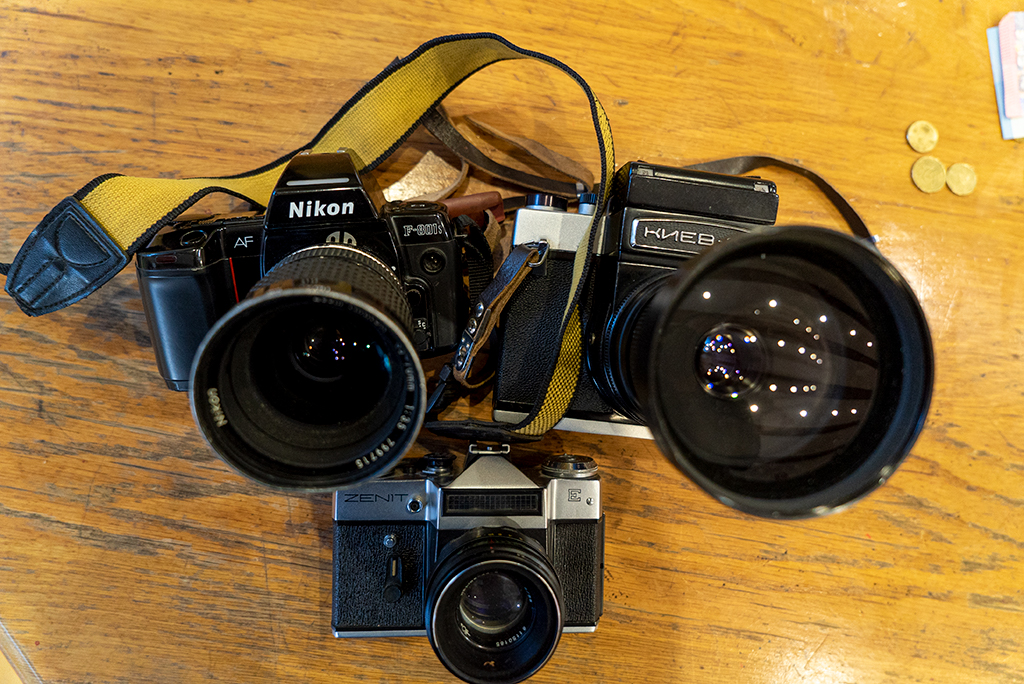

A friend wanted to get rid of his cameras so he gave me these 3, a Nikon F-801S (N8008s), a Kiev 6S (6C) and a Zenit E. I have enough to play with for a while. It is great I own a 180mm 2.8 Sonnar with a p6 mount so it should be compatible with the Kiev 😀
Nikon is loaded with a half used film, but it needs to be cleaned thoroughly. I think I'll have to remove the film. Do you think it is possible to rewind the film back and then use it again? I like the looks of expired film images, so it would be a shame to waste it.
I can't turn it on yet as one battery oxidized so I need to clean the contacts, I'll do it a bit later...
I'm not sure I understand how does the Kiev work exactly, sometimes the lever comes back by itself after rewinding and opens the shutter, as if I fired the button. Might be faulty. I'll try to find a manual for it... But first I'll try to get the Nikon working.
I don't know what to do with Zenit, as I already have one... I'll probably sell and give the money to my friend 😀

ok all kidding aside, you just need one working camera. One. Maybe you can get that Nikon to work, but sometimes a leaked battery can ruin the electronics.
Again, you just need one decent, working camera. Stop wasting time on basket cases that may or may not work, may or may not focus correctly etc.
Unless what you want to do is fiddle with stuff instead of enjoying taking pics.
My advice is to get rid of all the junky stuff. Try and get some money for it. Save up a bit if need be so you can get a decent camera and lens that works properly. There are so many decent cameras out there for under $100.

Yes, the junk is breeding. I should start selling the offspring...
I've cleaned everything and put the batteries and the Nikon seems to be working nicely. Although I find it quite big and heavy, so probably won't stick with it for too long.
I feel the Olympus om-1 might be just right for me, I'm just waiting for the right opportunity to come and meanwhile I will shoot with Nikon...

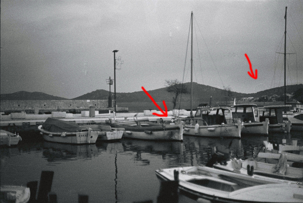

Hi, does anyone know what might have caused these? I'm not sure did it happen in camera, or while developing?
Thanks

Those look like drying marks on the film. Happens when no proper cleaning is used on negatives before scanning 😴
I agree -- water spots. If your final rinse is distilled water you'll see far fewer of them; they're a ring of formerly dissolved minerals from tap water left behind when the water evaporated. Wetting agent final rinse will help, causing the water to sheet off instead of standing in drops as it dries, but too much wetting agent can cause these as well. Follow directions.
Actually looks more like fine hairs/dirt. Drying marks are more splotchy. I get both all the time and just clone them out in lightroom.
Thanks, so this is not my fault as this happened during developing. I suspected this :smile:
I'll go to an another place next time to develop and see what happens

Is that a scan? I'd be more worried about the uneven exposure across the frame. Especially the left 1/4
It's a scan, I didn't notice really . Probably thought it was lens vignetting, but now I see it is not the same size on both sides
