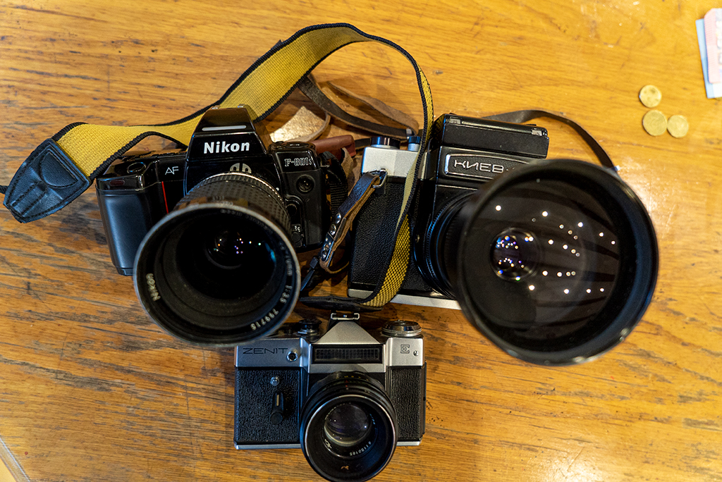

A friend wanted to get rid of his cameras so he gave me these 3, a Nikon F-801S (N8008s), a Kiev 6S (6C) and a Zenit E. I have enough to play with for a while. It is great I own a 180mm 2.8 Sonnar with a p6 mount so it should be compatible with the Kiev 😀
Nikon is loaded with a half used film, but it needs to be cleaned thoroughly. I think I'll have to remove the film. Do you think it is possible to rewind the film back and then use it again? I like the looks of expired film images, so it would be a shame to waste it.
I can't turn it on yet as one battery oxidized so I need to clean the contacts, I'll do it a bit later...
I'm not sure I understand how does the Kiev work exactly, sometimes the lever comes back by itself after rewinding and opens the shutter, as if I fired the button. Might be faulty. I'll try to find a manual for it... But first I'll try to get the Nikon working.
I don't know what to do with Zenit, as I already have one... I'll probably sell and give the money to my friend 😀
