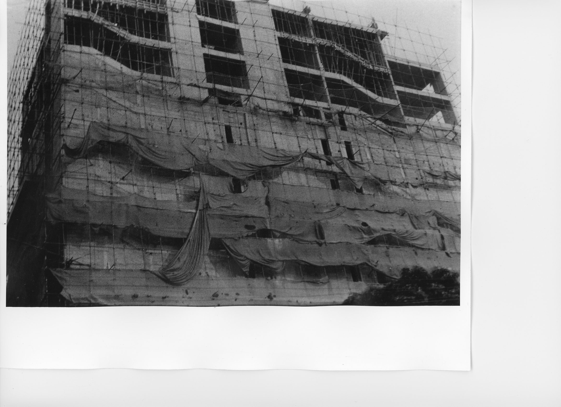

I'm back with the images that I could scan.
Because of the smaller size of the print i printed at the friends place i misinterpreted as higher in sharpness. But now when i,look at 1/and 3/ i see there was not so much difference , it was only underexposed. I think i like underexposed print.
The difference between the old lens and the new is obvious clear. The newer lens has more contrast and better separation of the tone values.
1/ smaller print , (at friends place), with the other lens (17 cm on 11 cm)

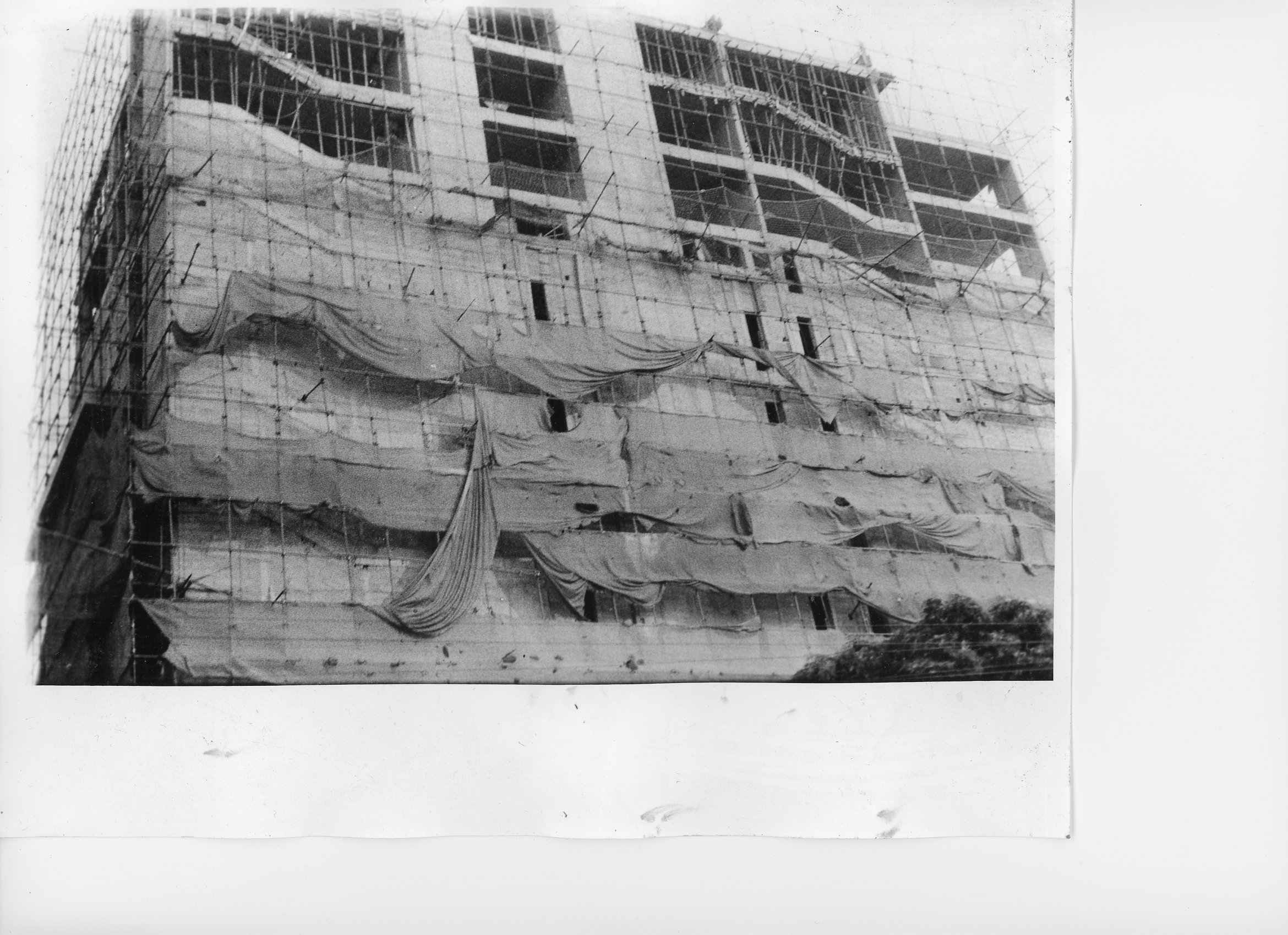

2/ old lens print ; flat appearance low on inner contrast (29 cm on 20cm)

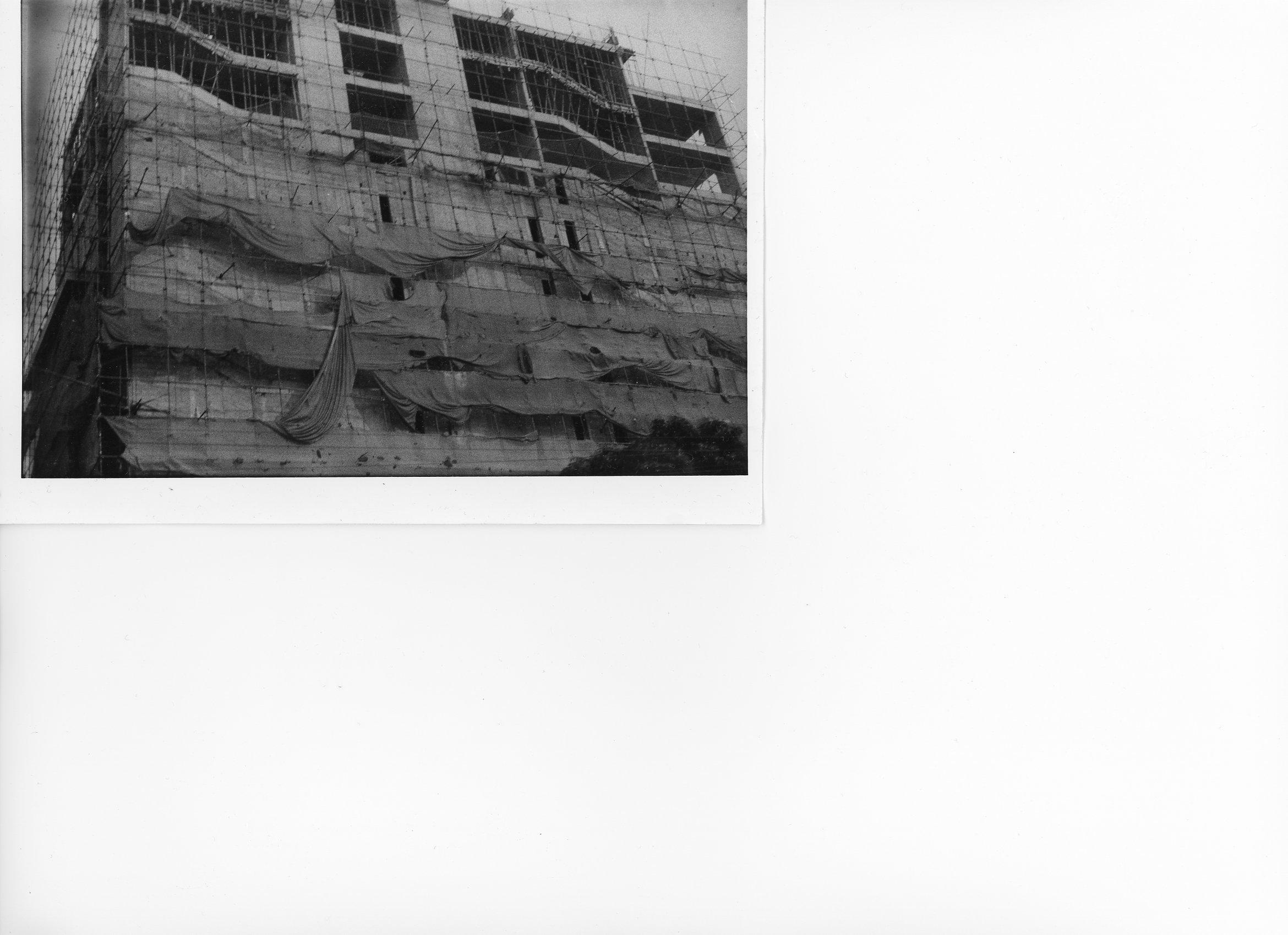

3/ new lens on enlarger print , but underexposed (24 cm on 16 cm)

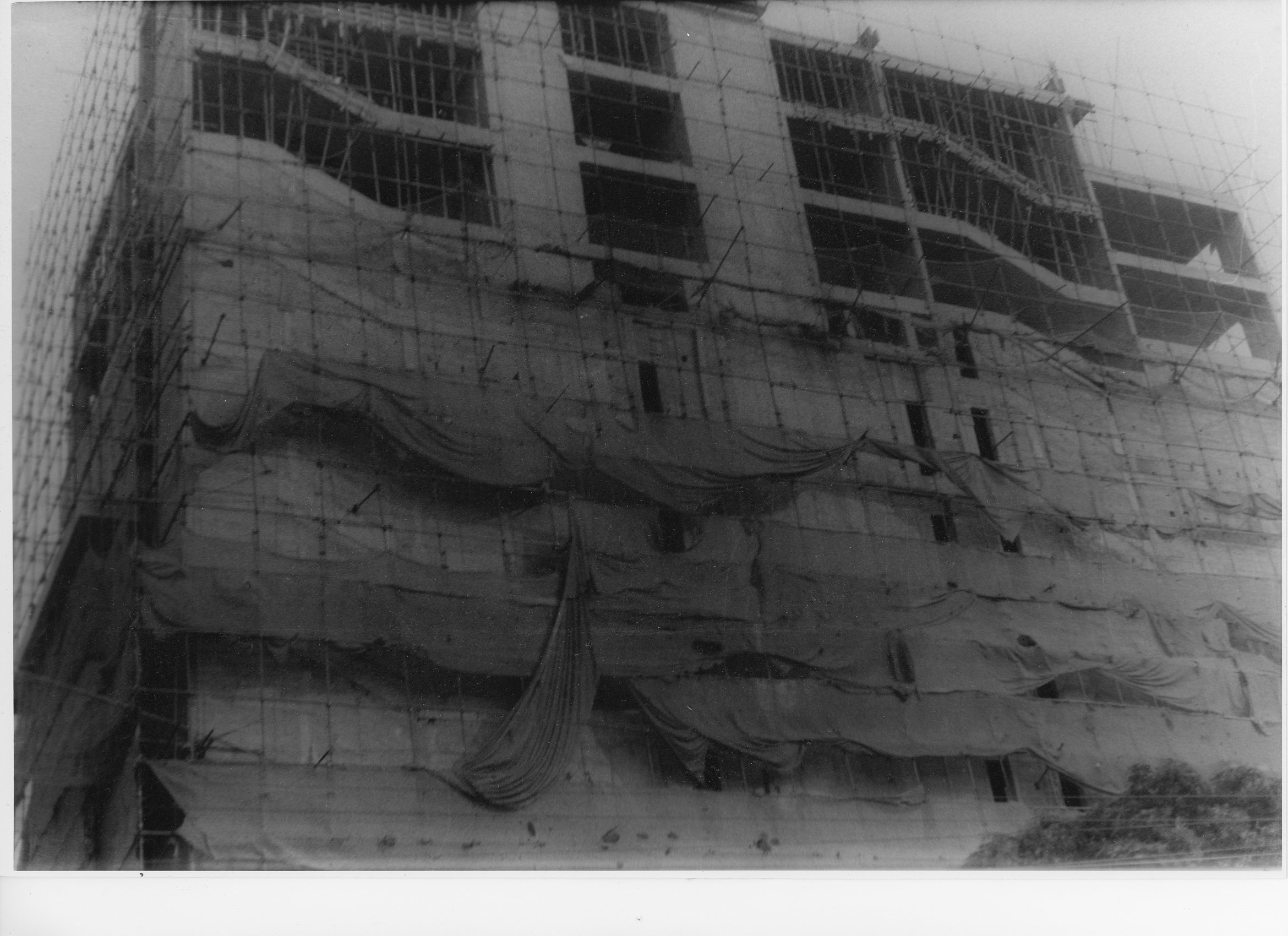

4/ new lens on enlarger print , (24 cm on 16cm)
Hope that some people can learn from it.

First of all, the image itself seems to have a little bit of motion blur to me, but I see it in all four prints, so it's not something specific to your home lab. I suspect the negative is just slightly blurry.
The difference in sharpness between print #2 and prints #3 and #4 is absolutely significant. Also, print #2 is much darker in the center than at the corners. What kind of enlarger lens did you use for these prints? And what aperture do you set them to when actually exposing the prints? Keep in mind that focusing is usually done with the lens at its largest aperture, because this makes the image easy to see. But for the actual print, you generally stop down by at least 2 stops (so a f/2.8 lens you would use at e.g. f/5.6 or f/8). This generally gives better sharpness, contrast and especially it reduces light falloff in the corners.
If you exposed print #2 with the enlarger lens at its widest aperture, I'd suggest trying again at a smaller aperture and see what you get. Even so, however, print #2 is low in contrast that either there must be something wrong with the lens (e.g. it was opened for cleaning and incorrectly re-assembled). Another possibility is that the lens was mounted incorrectly on the enlarger and/or there's something odd going on with the lens board. I have this sometimes on my Durst 138, where if I mount the lens slightly out of alignment, light spills past the lens board, severely degrading contrast very much like in your print #2.

I don't think I see much difference in sharpness between the examples above. BTW the one you call underexposed seems exposed about right to me; the others have no white in the picture. Ultimately the grain has to look sharp; image content seems probably affected by camera shake.
I agree, the one labelled "underexposed" looks reasonable with visible detail, while the others look muddy.
