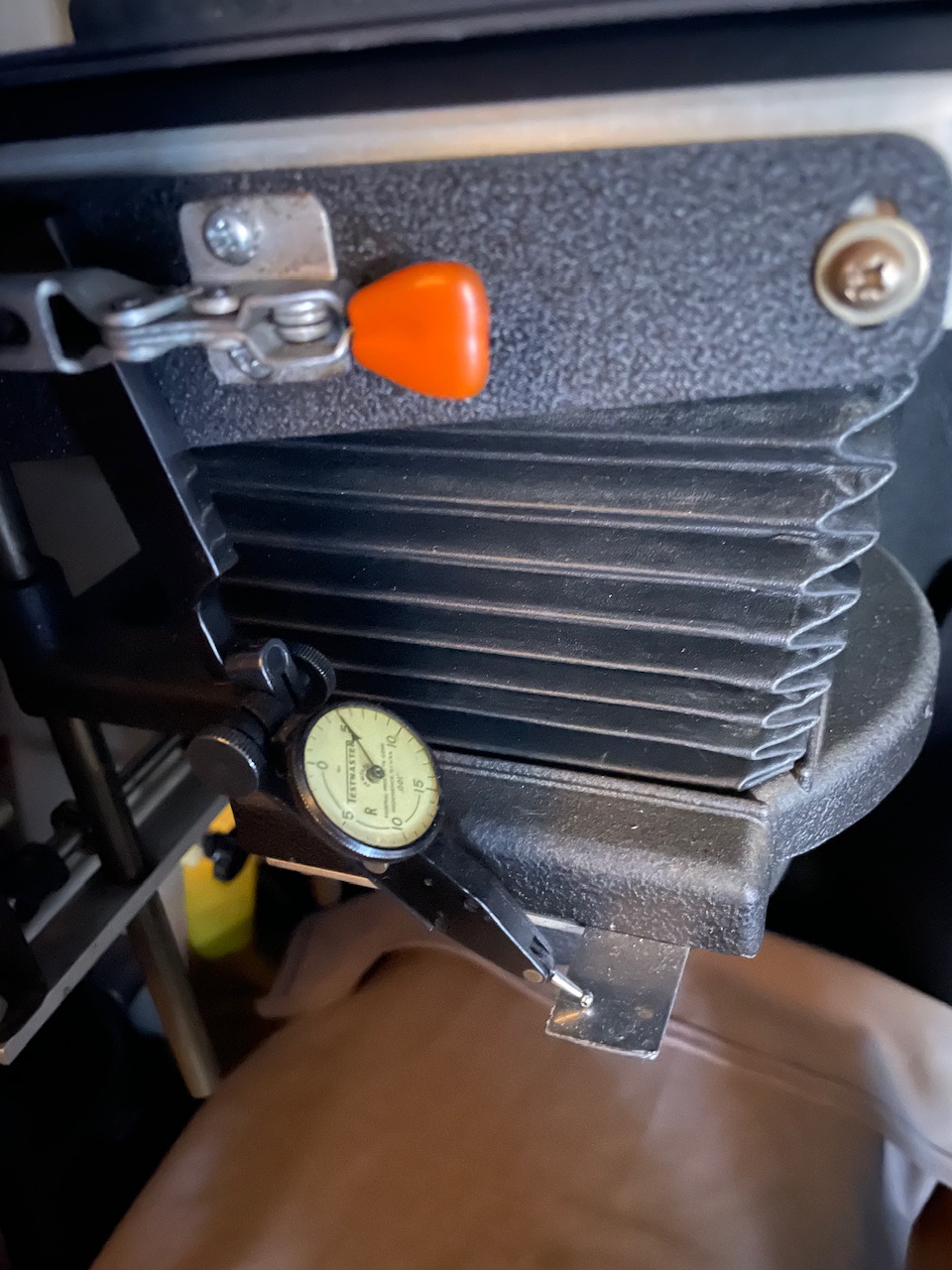

Then I attached a dial caliper to the negative carrier stage and found that I can measure the depth of focus at the negative carrier in thousandths. And I can split the difference between top down/bottom up focus position. Then I can tell the difference between whether or not that sheet of print paper is under the grain focuser... and it amounts to 10% of the focus "depth of field".
Now I don't like systematically using up 10% of my tolerance in focus when printing, so I have gone back to putting that piece of paper under the grain focuser.

With the 0.012” (0.30 mm) thick sheet of paper under the focuser, the distance from the negative to the first nodal point of the lens is 55.3763mm.
If we omit the sheet of paper, the distance is 55.3728 mm, an error of 0.0035 mm.
This distance determines the focus of the projection. The difference is beyond trivial.

Insignificant but measurable. I’m using a dial caliper these days. Focus up, move dial to zero. Focus down, read the dial. Move focus to the midpoint.
Grain focuser on the scrap sheet of paper.
Including the sheet is insignificant, but it’s effortless to be measurably more precise.
So I include it.
