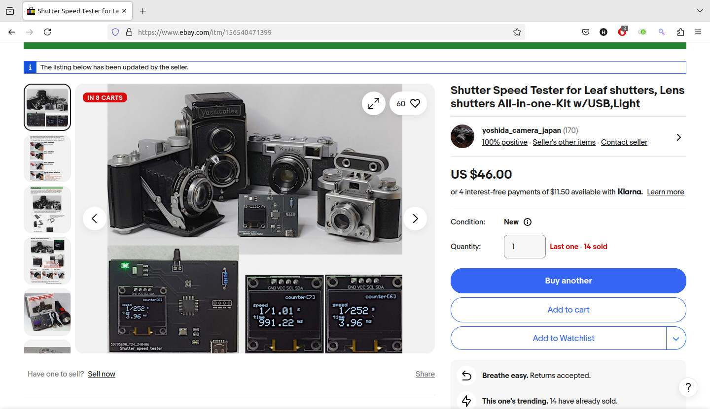

F4U
F4U
Jan 15, 2025
638
Florida
8x10 Format
Thank you all. If I may wrap this up with a last question. This is the shutter tester I'm using. Doesn't exactly inspire confidence in my technique. When i restore an old ham or shortwave receiver or a reel to reel tape deck or signal generator or something I know that it IS right and accurate because I have the test gear that can handle the job the right way. Shutters, not so much. Question: Should I forget my belief that the springs are old and tired, and that SPST actually did get it right, or continue using 1/200 to get 100 and 1/400 to get 200?. I really don't want to do any more test negatives. Before sending it off I actually did open it up to do the job myself, till I realized I could get into big trouble. When you dive into a Compur shutter, it'll separate the professionals from the rest of us real quick. And I knew I could end up with a big fat mess in a heartbeat. Thank you
