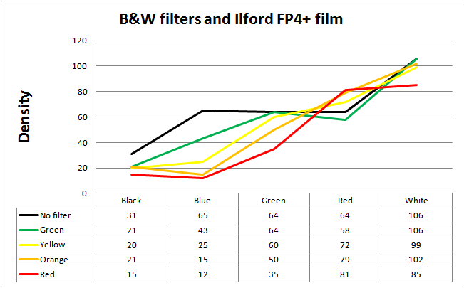

To assess the effect of colour filters on FP4+ black-and-white film, I took shots from the AGFA GEVAERT colour test chart. The test chart was photographed on a sunny day. Numbers in the table are measured densities of the additive primary colours blue green and red. And black and white as well. When it comes to rendering the colour green, there is to my surprise little difference between a yellow filter or a green filter.

There must be something wrong...
How can you yield a higher density (and thus exposure) with a filter than without such?
Two things play an important role. First, each filter colour has its own delay factor. The camera compensates for this by exposing longer. The entire density curve slides up as a result.
In addition, compared to an image without a filter, each of the filters used makes the colour red lighter. On the negative, this results in a higher density. A blue filter would produce the opposite effect.

But this then is a nonsense approach, by letting the camera compensate the filter. What do we learn from your graphik then?
As you and I know, this is a simple matter. Each of the B+W filters in my test have a specific filter factor which is supplied by the manufacturer. TTL metering will correct automatically for a specific filter factor. The result of these different exposures are the density values in the table. And from this it can be seen that there is little difference between a green filter and a yellow filter in the representation of the colour green.
I did that for decades but when I attended Alan Ross' class in Yosemite, he showed me that that method was not always accurate and that one should always use the filter factor.
