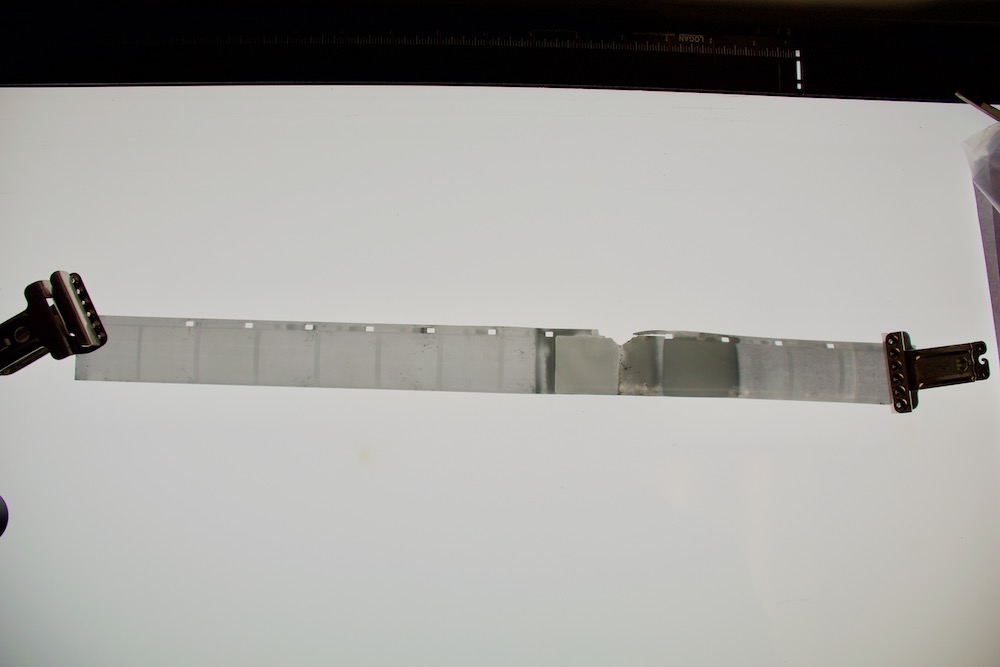

Well, tonight, I tried a 126 Verichrome Pan I found last week (left on exposure 5, camera wound up being broken) at 9 minutes in sprint standard per d76 recommendation. I think I did it right, but I got a blank roll. Thanks for the information as well.
