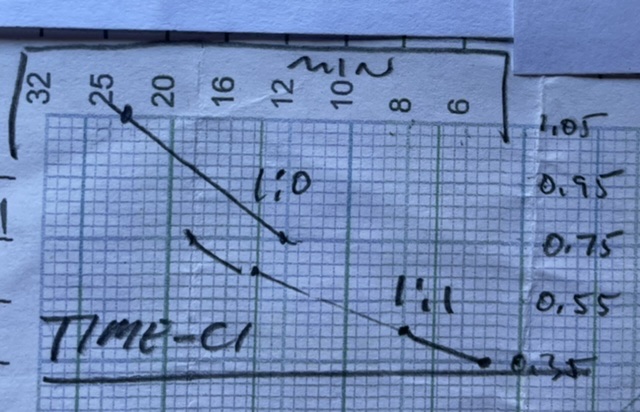

That’s a great question. I developed for a variety of times between 4 minutes 1:1 and 48 minutes stock. 48 minutes was the longest I ever tried and it results in a 200 speed ( by looking at where the curve crosses 0.10 above base+fog. )
Now I just looked at it under a Delta-X template and the speed by Delta-X is only 125 at 48 minutes.
And the real useful data is the Time-CI curve, here showing the development time in D-76 stock and D-76 1:1 .. and the expected contrast you will get.

Thanks Bill I admit I didn't fully understand some of what you said but clearly the dev time of 48 mins was correct. In layman's terms as that is about all I understand, can you say how different the 48 mins negs were compared to the 4 mins. If a newcomer had said he had developed TMax 100 at 48 mins and the negs looked funny I suspect he'd have been met with cries of astonishment and comments like" no wonder they were strange" what made you do this when Kodak suggests 6.5 mins etc and yet I assume these were usable negs?

These are all test negatives and they show what the film can do. I didn’t mean “hey develop 48 minutes to get 200”. I meant “200 is all you can get out of this film even if you develop for 48 minutes”.
Anything under the great triangle made by the curves is possible to get with this film.
To the left there is blackness in the print. You have to hit this film with enough light to make it up onto one of the lines. In the long run you want some part of the picture to get up around 1.2 in the density scale.
With 48 minutes in D-76 stock, you can take a light meter reading and set the camera off a piece of paper with meter set at 100. Then pull the paper and make a portrait of a friend. Then your friend will look great but the rest of the picture will fall off to black like a Hurrell portrait.

Thanks Bill So what you did was an experiment to test the limits of TMax 100 in D76 and one of those limits was 200 no matter what you did even with 48 mins
What I think "by the rules" users like me can take out of it is that provided we use the Kodak time as the safe lower limit then even if we over develop by a minute or two the neg remains perfectly printable and probably to the extent of most viewers of the resulting print no even noticing

Right, it’s a study of possibilities and shows flexibility.
Anywhere between 10 and 12 minutes in D-76 1:1 at 20-degrees C will give good negatives with a real speed of 100.
