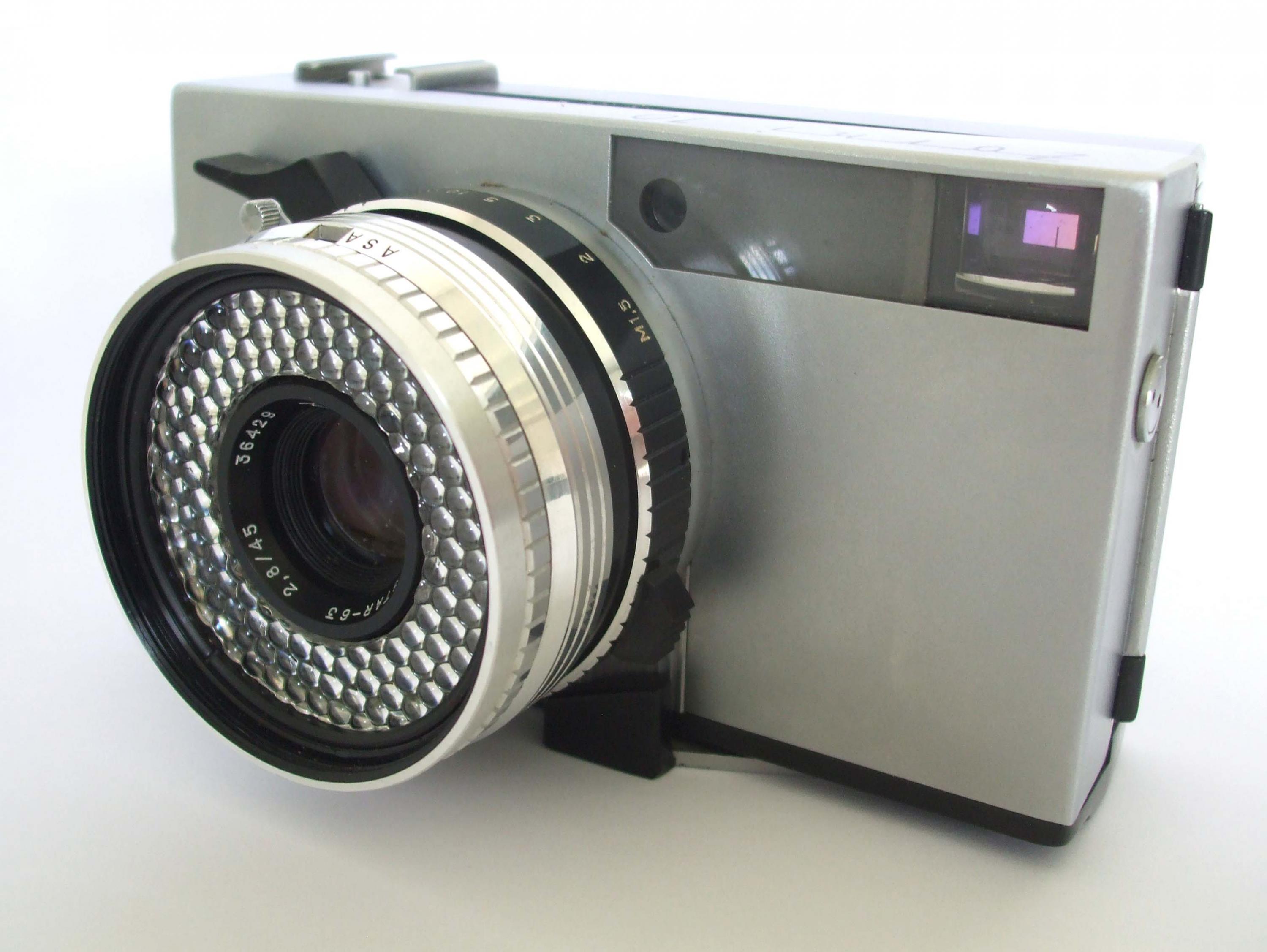

A cool looking USSR Space Age Zorki 10, fully functioning and in excellent condition with case etc.
attachment.php
Nice Zorki!

The rangefinder is slightly out, I've got a repair manual but the images are unreadable, so off to the USSR forum for some help!

Glad you like it. The meter works, rangefinder is spot on after a bit of easy adjustment.
Just need to try it with film now.

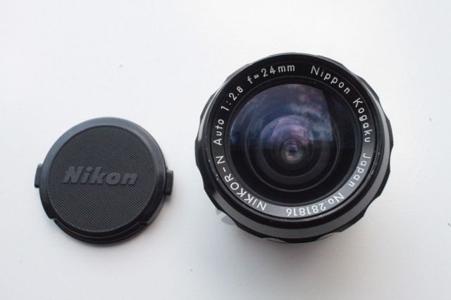

From Ebay: Nikon F black # 7058253 (Nov 1969) with Photomic FTN (working light meter) and a NIKKOR-N Auto 24mm 1:2.8 non ai Nippon Kogaku from the same period.
Can't wait to receive this camera and start using it. It is (almost) as old as I am.
