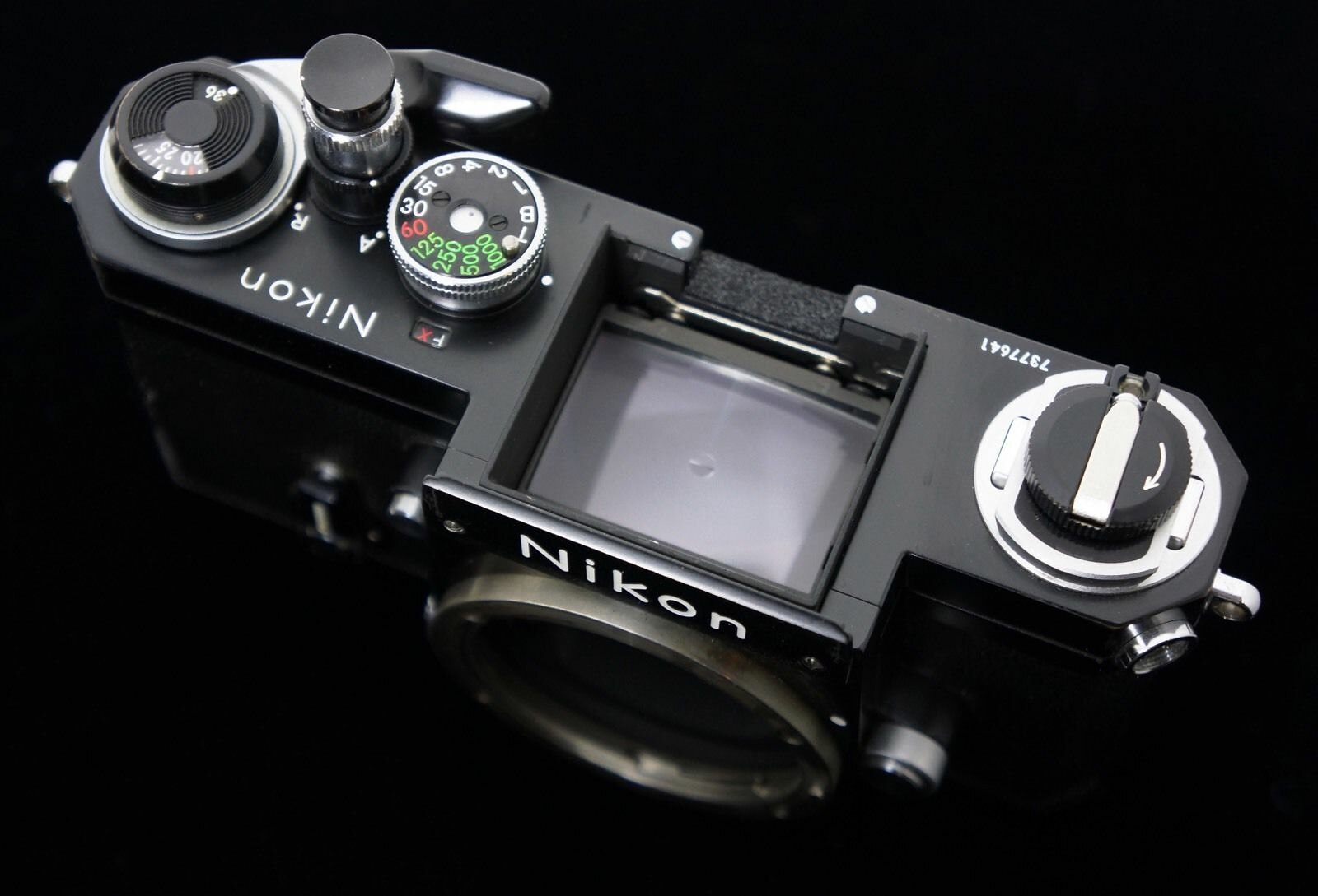

When I got the box finally opened as the seller had packaged it for Armageddon, I was grinning like a mule eating briars and how good it looked. For it's age, phenomenal. I should look as good for my age! Someone really babied this camera. I'm going to run out today and look for batteries for it. It seems to be begging for a roll of Tri-X to be put through it.:smile:

They look good and they feel really solid. I had a black Nikkormat FT2 and it was quite a looker. My advice? Get a technician to give service (cleaning) to the variable resistor ring that is around the shutter speed ring. It is crucial for the metering to keep working for years to come.
