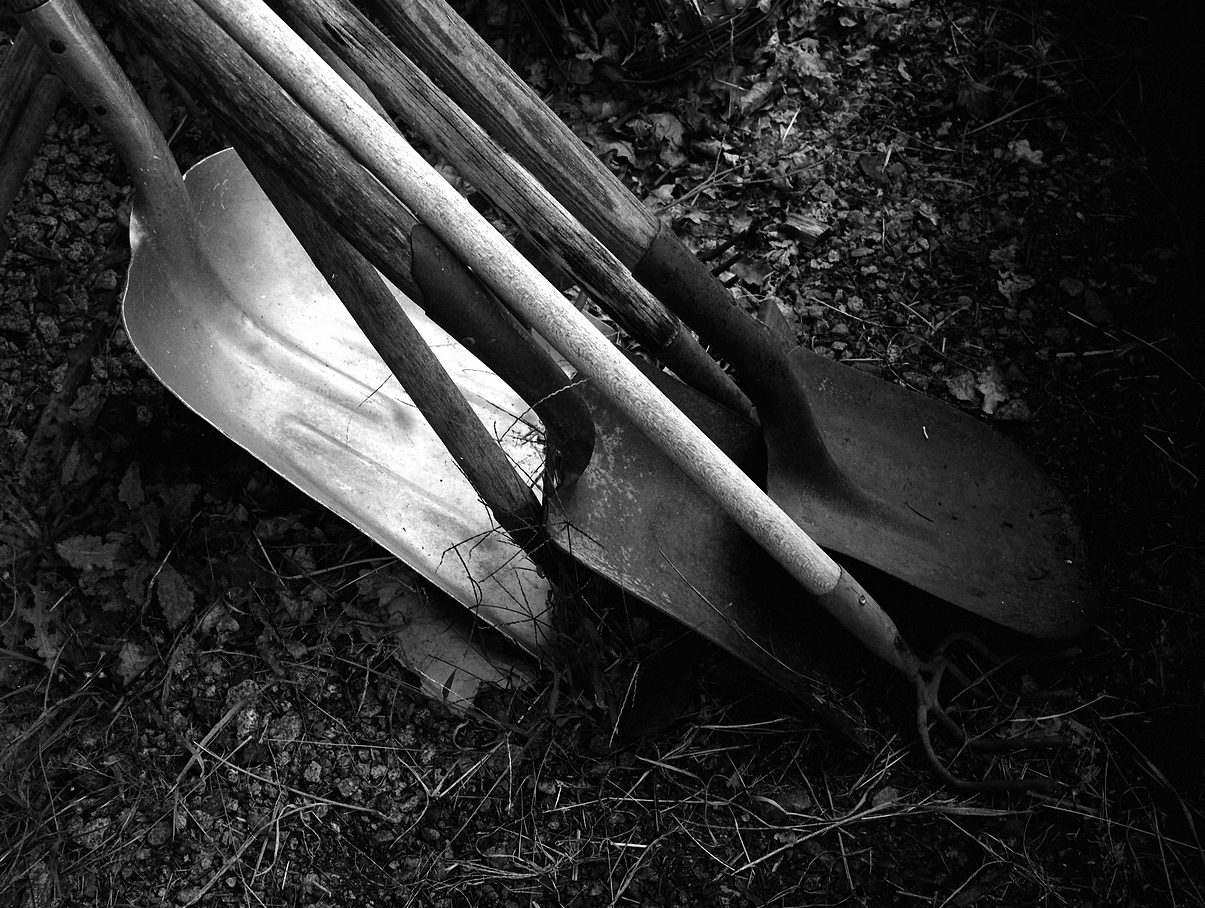

That shot was metered at box speed, and developed in replenished HC-110 dilution E. IIRC, I increased my development time by 10%
It seems your shot is an example of a mild push too... One that looks and works fine for overcast... It looks like TMY can't reach normal contrast at 400, but at 200-250-320 in HC110... Isn't it why Kodak went for xtol, after designing Tmax films around d-76? TMY @ 200-250 in d-76 is beautiful... If you ask me, even if some people can prefer your photograph a bit more open tonally, say one or two thirds of stop, or box speed but in a faster developer that reaches box speed, I prefer it the way you made it: it has a lot of character, and in the other case, it would be a little cleaner but it could easily start to wash out and lose personality... Just my opinion, of course... You made a great negative, and also a great print for the subject.
I think we have a difference in terminology. I don't consider that increase of development to be a "push", but rather an expansion.
My replenished HC-110 dilution E gave me box speed consistently. All I needed to do was fine tune the development time to give me the normal contrast I prefer.
I decided to increase the development slightly for those rolls because of the diffused nature of the light that day.
In more recent times I've transitioned to replenished X-Tol, but as I still have some HC-110 replenisher, I leave open the option of using replenished HC-110 again.
Here is another photo which was coincidentally shot at the same location several years later. TMY again, and still replenished HC-110 dil E, but the light is distinctly different - open sky here, but otherwise sun and cloud - so I relied on adjusting contrast at the printing stage. The metering was keyed carefully to the highlights.
This is a scan from the negative. The prints are slightly lower key, and toned using brown toner.

All I have right now is this phone and I don't know how to share addresses or images... There's an example there (post #35) with one of the best tones for expansion I've seen, ever... It's TMY2... It's not easy to do it, IMO, that well... The thread started in November 2019 and it's called Recommendations for 35mm MF Nikon lens for the FM... An old woman with her hands on a grave... Impressive! As the kid told me some time ago, not box speed, and and not standard developer either... He didn't even develop his film: it was a lab!

If anyone's interested, the woman/grave shot was TMY2@320 in Clayton F-76. That made me take decisions, getting into acutance, speed developers that don't depresss middle tones...
Thanks Juan, but that particular example didn't involve any expansion.
It was metered at box speed and developed normally.
What I did do was emphasize the highlights when I took my meter reading, knowing that with TMY if I gave the highlights generous exposure, the shadows would fall naturally.
The pleasing contrast comes from the printing/post processing choices.
