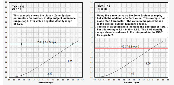

I've attached an example of a couple curves with some analysis as an example of how I was able to answer a question that had been perplexing me for years. As with most people who want to get serious with photography, I began with the Zone System. I learned that a normal negative is one with a negative density range of 1.25 from a scene luminance range of 2.1 (7 stops). Later when I started reading about sensitometry, I learned that a normal negative density range for printing on a grade 2 with a diffusion enlarger is 1.05. Why the discrepancy? And why did both methods produce printable negatives on grade 2?
I got my answer using the program. Both curves are identical, the only difference are the testing parameters. The ISO/ANSI model assumes flare. The discrepancy turns out to be an illusion. One can the validity of the various theories, but the question was answered.
