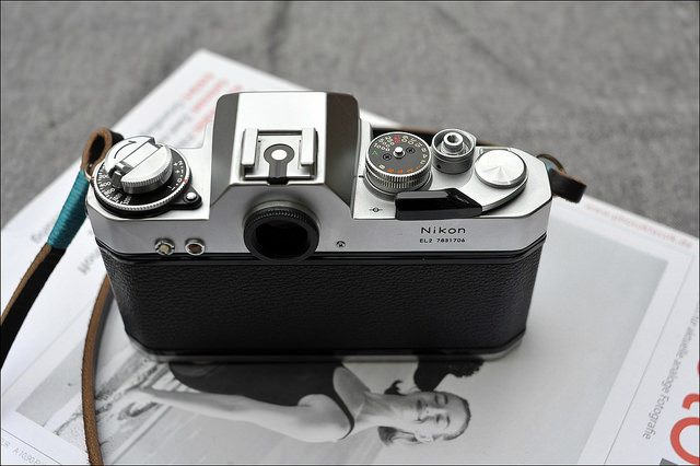

Before 1977, the only Nikon cameras in existence were the F2, the Nikkormats FT3 and ELW.
That would have been the Nikkormat FT2, not the FT3.
The Nikkormat FT3 was introduced in March 77, 2 months before the EL2 and at the same time as the F2A and F2AS.
The Nikon FM was introduced late 77 and the FE in 78.
