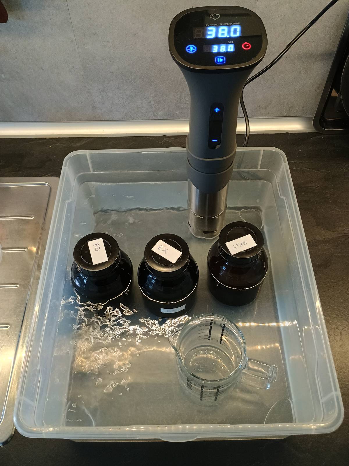

Now I am using the Adox C-Tec Kit C-41. Works good and easy.

Adox C-Tec Kit C-41, 38°C
