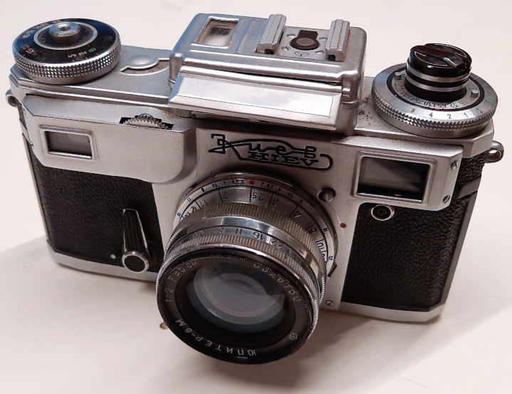

Kodak Double-X in a Kiev 4M type 4. I found this camera on my dad's attic and ended up 'film-testing' it.
Be careful, those Kiev-4s can be addictive. They're linked to so many photographic "firsts" through their Zeiss and Ludwig Bertele heritage... though with more recent manufacturing so not suffering as many effects of age and war.
