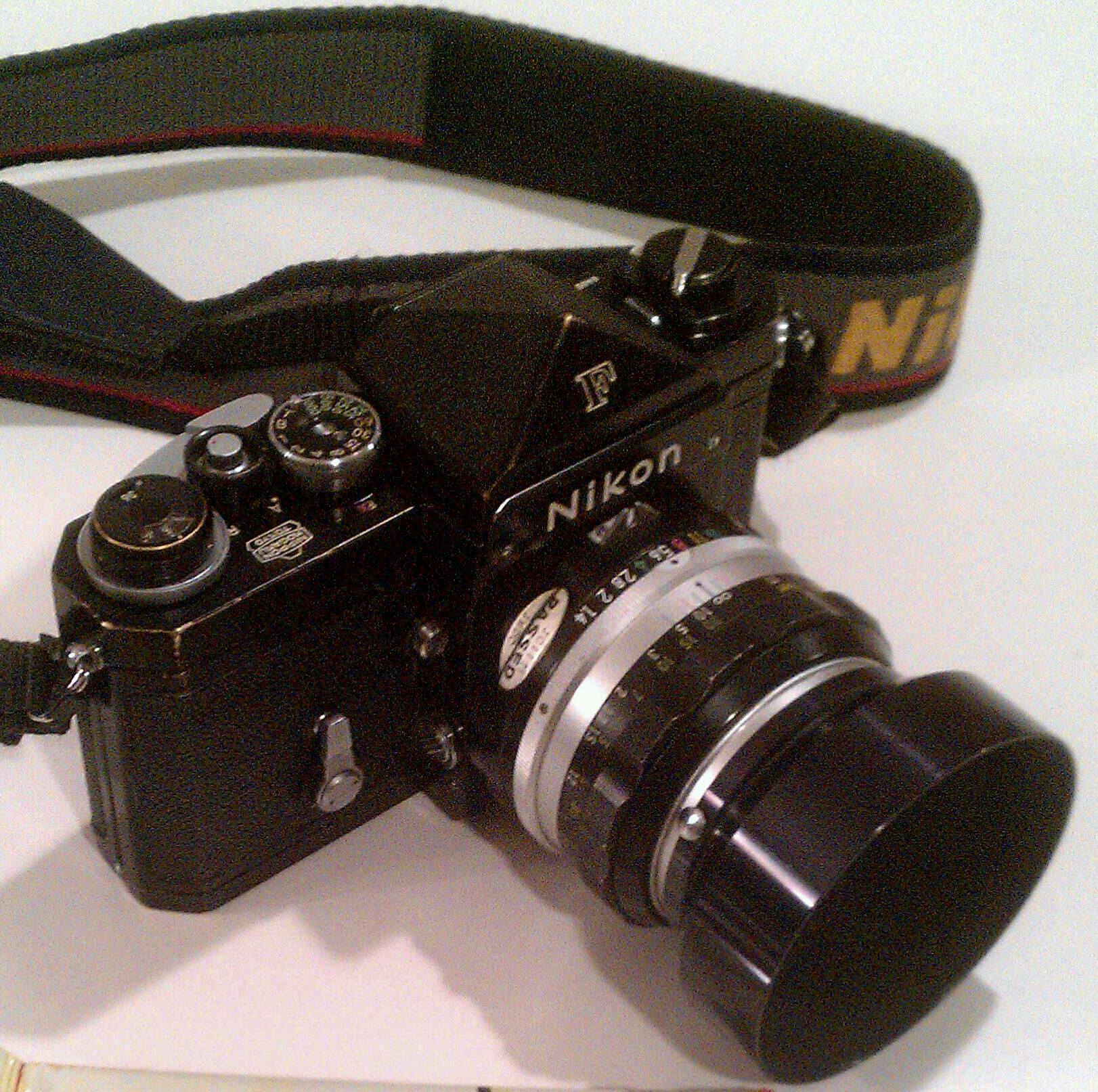

Still using one of my plain-prism Nikon F's, the black one, with Ultramax 400.
Prints from FM3a and Ultramax 400 were excellent. Continuing with Ultramax in the Nikon F and now also in a GR1:
