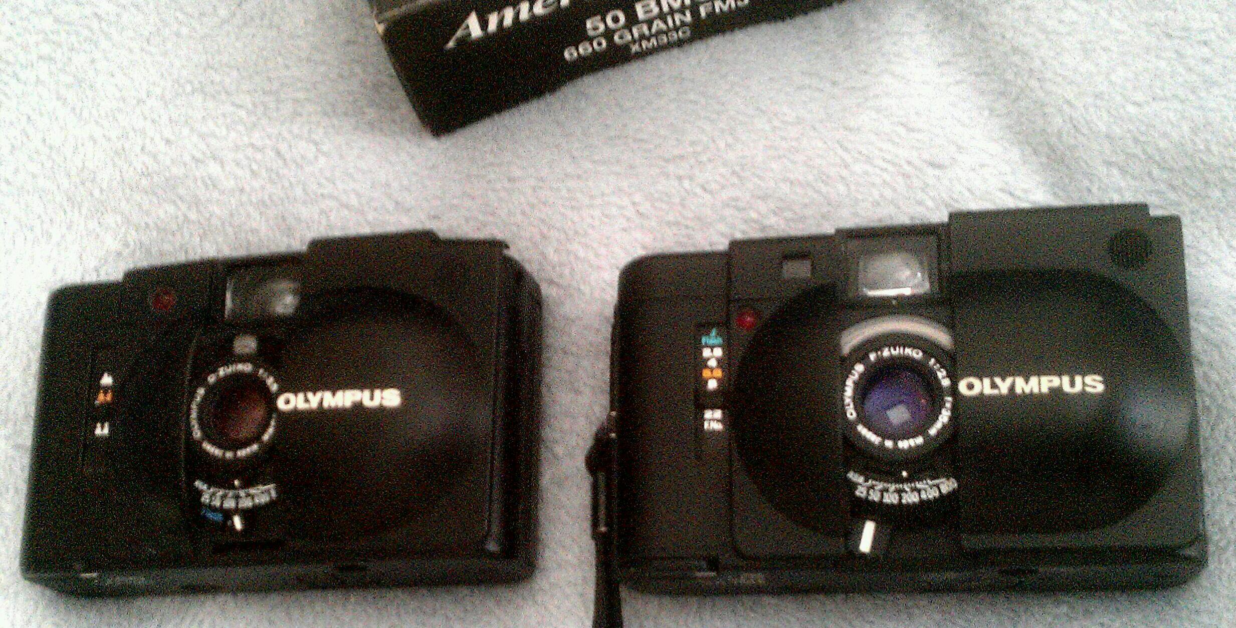

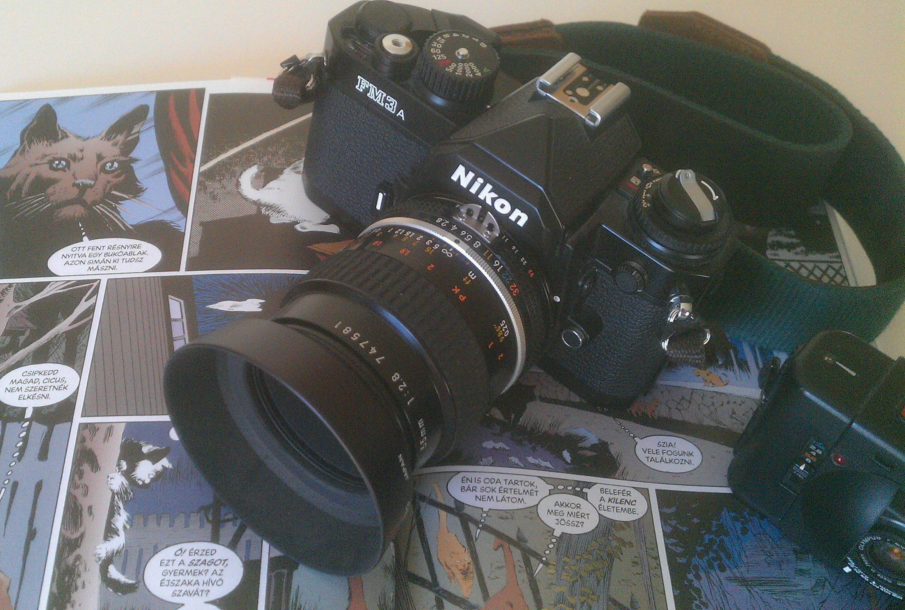

I ran multiple rolls of Kodak Gold 200 through my FM3a and Olympus XA; the results were very good.
I hadn't used the FM3a in quite a while, so it was fun to use again. I even made a great macro shot with its 55/2.8 AIS plus PK13.
This was the first time I'd used the XA, which I bought a few years ago. Exposure meter is accurate, viewfinder needle is accurate, rangefinder is excellent. Got some great shots, especially close-in.

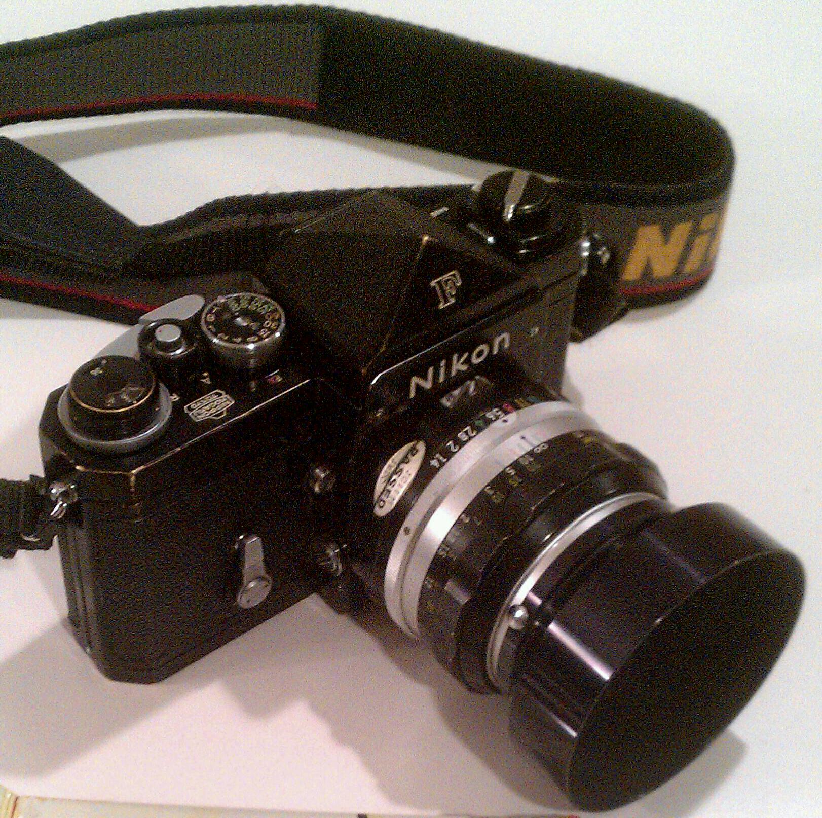

Still using one of my plain-prism Nikon F's, the black one, with Ultramax 400.
