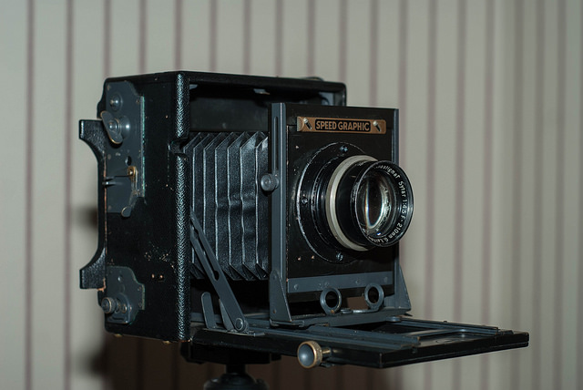

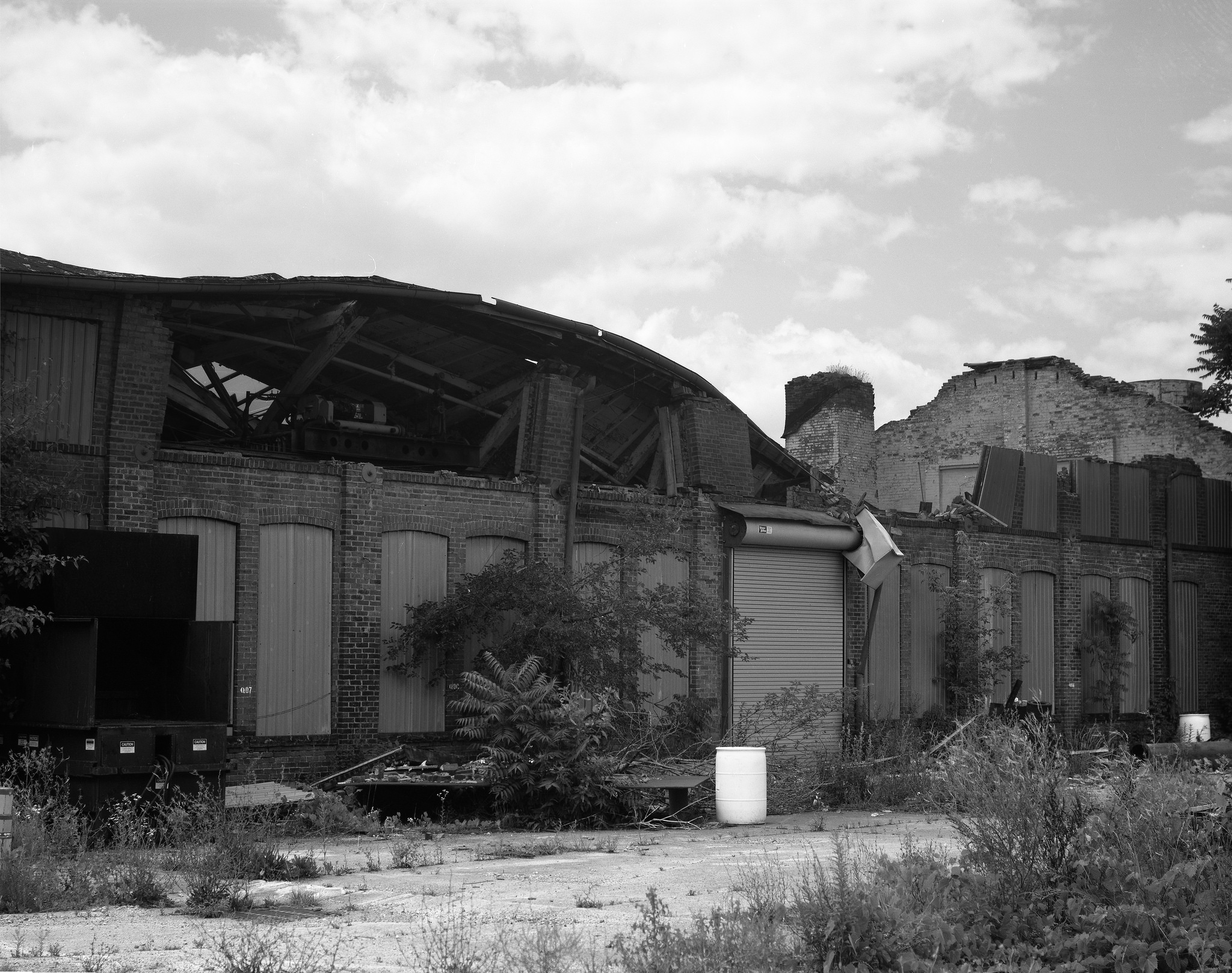

This one. Pre-Anniversary Speed Graphic 4x5 with a G. Leitmeyr Sytar 210mm F=4.5 barrel lens. Kodak Tmax 100 12 minutes in HC-110 dilution H (1+63) @ 68 degrees.

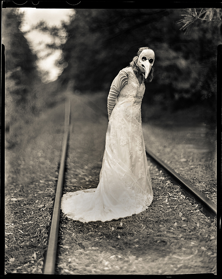

Speed Graphic 4x5 with Aero Ektar lens; Ilford HP5 in Ilford developer. Resulting image attached.
