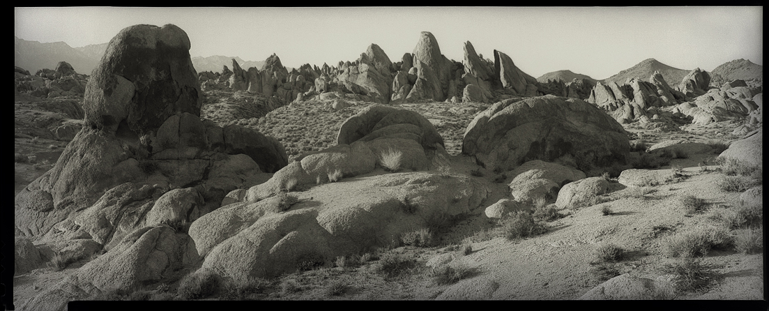

From my last camp on the way home (Alabama Hills, with FujiW 250) -- 4x10 negative photographed on a light table and inverted in PS.

Hi Vaugn,
Very nice landscape and negative format. Dit you use a special film holder for this 4x10 format or did you use a regular 8x10 film holder?
