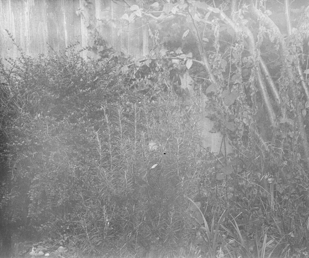

Polaroid Colour Super Swinger, non working shutter ...
... dismantled it, removed the shutter, used a home-made ground glass to establish the proper film plane, fashioned a lens cap from duct tape and cardboard, put an Ilford HP3 quarter plate in (manufactured 1946/7) and made that sit tight with a piece of foamcore.
Guessed by eye that the "3000 speed" aperture was f/22, guessed a fall of 1 stop in speed per decade for the plate and exposed it for 16 seconds.
Developed in home-made Parodinal diluted somewhere between 1:25 and 1:200 for something like 12 minutes.
Needs more work ... :wink:
the 3000 speed setting would be closer to f50.
