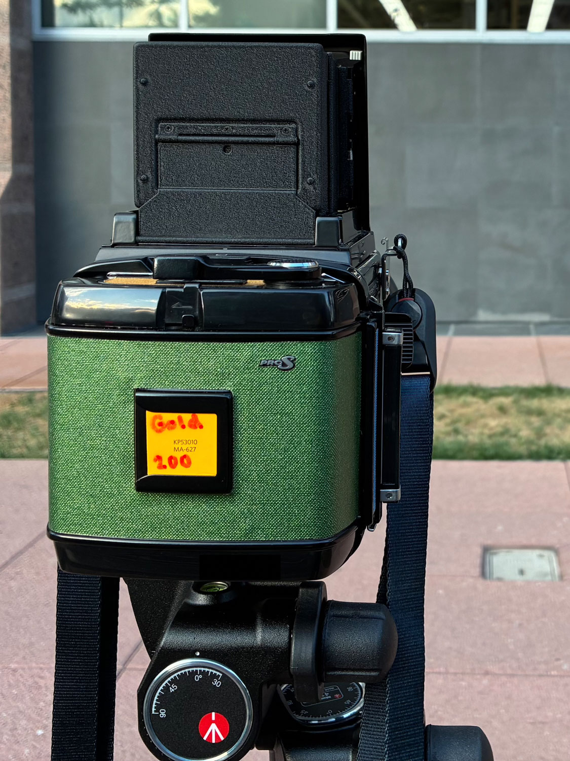

Thank you everyone. I am still slowly rolling through comments when I have the time.
I decided to purchase the Manfrotto 410 tripod head because I plan to do studio and field work.
So my setup will be:
- Legs: Manfrotto 055XB (discontinued, aluminum)
- Center column: Manfrotto 055XSCC
- Tripod head: Manfrotto 410 Junior Geared Head w/Quick Release
That is 7.69 lbs total. Nice and portable for long walks in the park and trekking - just like the RB67.
I will upgrade to lighter, stronger sticks eventually. The 055XB sticks are rated for only 15 lbs.

I assembled the tripod today. My scale reads 7.4 - 7.6 pounds. The Manfrotto 055XSCC Shorter Center Column for Select 055 Series Tripods does fit the Manfrotto 055XB (discontinued, aluminum) legs.
I can feel the back pain already.
I took the tripod for a spin.
I am exhausted.
The head worked ok with the waist level viewfinder and a 127mm lens. I think my chiropractor may end up appreciating this purchase more than me, though.
I will try adding the prism another day. Definitely do not consider this a review...I will be back with more comments as I use it.
