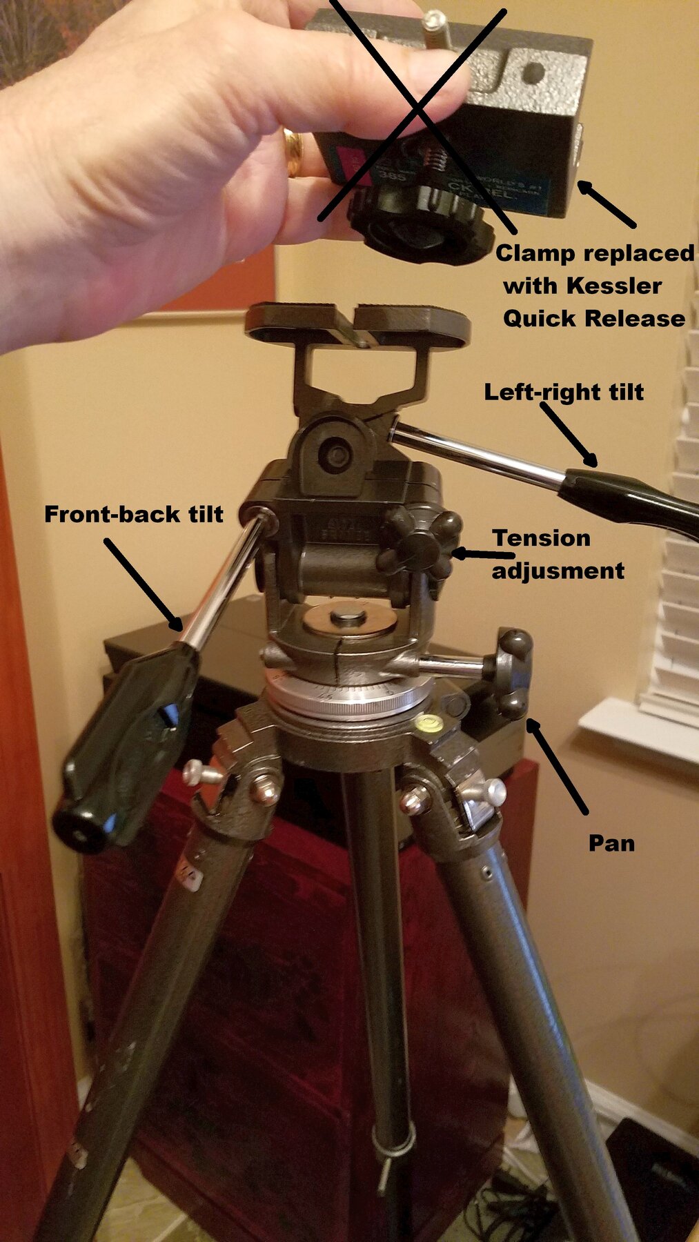

With my RB67, I use an old Gitzo Studex Pro series 3 and their three-way head. The tripod, release, and head weigh around 9 pounds, but I've used it for 40 years. I'd probably get a carbon fiber today. Tripod extends to 75" to eyepiece without center column extension. Solid as a rock, even with my 360mm lens. I never tried a ball, but the three-way allows unilateral control in each of the three planes, making small adjustments easier than a ball, which moves in all directions at once, leading to drift into other planes. The 3-way has a tension adjustment that allows movements without slippage.
There is an RB67 quick-release plate for Arc Swiss releases. https://www.bhphotovideo.com/c/product/2127-REG/Arca_Swiss_802224_Camera_Plate_for_Mamiya.html I tried it with the Kessler quick release, and it didn't fit properly, but it could work with another Arca-Swiss releases. My quick release is now a Kessler setup (not shown in the picture). Good luck with whatever you decide.
