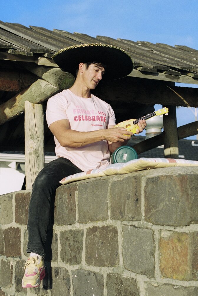

I am looking for any tips on what I should ask for in film scanning, And if anything can help in the editing process.
I have attached a few photos here.
1. The first is from the lab scan
2. The second is my edit making the clothes look as they should be. This was done on portra 400, however my editing has also now removed a lot of the film look. My issue seems to continuously be with light or white coloured clothing.
3. Photos 3 and 4 are Shot in very similar conditions, (also film) however the clothes retain the whiteness as they should be.
I’m thinking this Has to do with scanning more so than the film used?

It's difficult to get consistent looking frames from the same shoot when a lab does your scans. Even if your exposure is consistent, you're at the mercy of two things:
- the scanner software's auto exposure and auto white balance algorithm
- thesubsequent adjustments (if any) made by the person doing the scanning
One solution is the following:
1. Shoot all frames at the same exposure level (ie: box speed or plus one or whatever you're going for)
2. Get your scans done on a Noritsu as it has the ability to be consistent
3. Ask the lab to use the "Photometry Memory" function on the first frame. This locks in the same auto exposure and WB adjustments to all frames
4. Then the lab should copy the desired manual adjustments (contrast, density and colour) to all frames.
This should give you a consistent look.

That’s very helpful, thanks. I’ll Try that

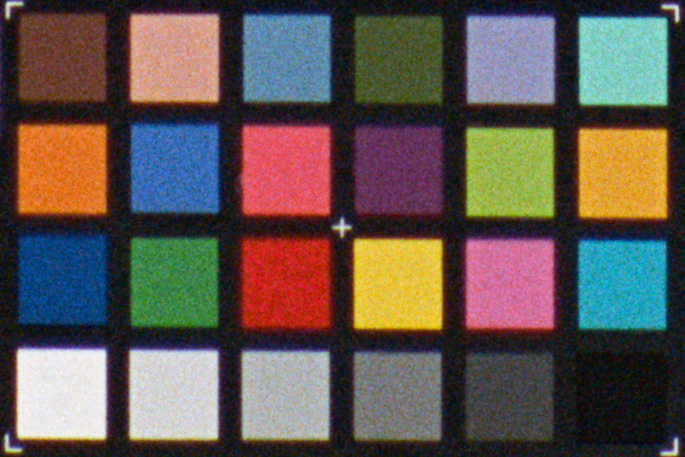

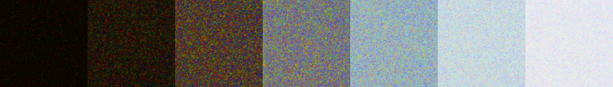

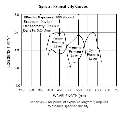

I have some experience of shooting bracketed exposures of colour charts on different film C41 stocks, scanning them in a very controlled way on a Noritsu and analysing the results. I agree with your assessment that overall colour balance drifts as colour changes so that if you colour balance for 18% grey at box speed you might find, with Portra 400 for example, that shadows are warm and highlights are cool :
Portra 400 -3 to +3, saturation heavily boosted to show the effect
And if you balance for the shadows the highlights get even cooler, and vice versa. And you can also see that a different "balancing act" is required to balance the midtones of shots that are under or over-exposed.

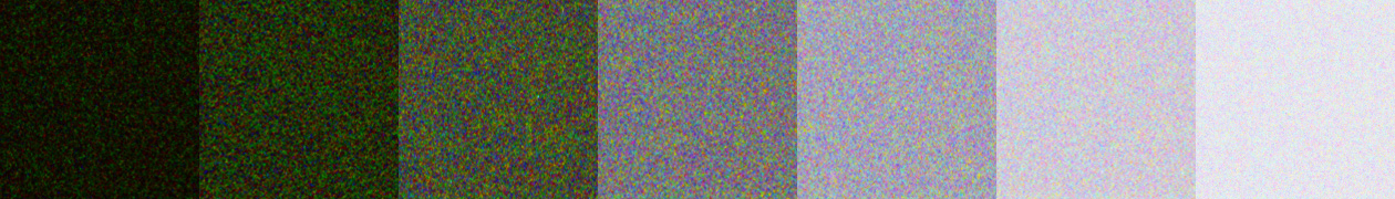

So yes, it looks like there is a colour curve for each film stock. Using the same methodology, Fuji 400 looks like this:
However, it's not the end of the story when it comes to the look of colour film, you might be relieved to hear. Yes, you can throw on a curve that will correct for the colour casts in shadows and highlights. However, the colours that remain are still intrinsically peculiar to that specific stock. In the case of Portra 400, to give one example, blue skies are noticeably more cyan than the slightly purple skies that you would (accurately) get using a digital capture. In the case of Fuji 400, green foliage is cool and minty and skin is quite pink. Let me illustrate that point in a slightly different way. Here is a Colorchecker shot on digital and processed with Lightroom defaults:
Digital
And here is Portra 400 with a curve added to match the above:
Portra 400, box speed, scanned on Noritsu so that middle grey is balanced, then RGB curve added to match the neutral patches with the digital capture
So now the colour casts have been removed. But it should be very clear that there's still a significant difference in the saturation and hue of various colours on the film shot. If you open each image in its ow tab and switch back and forth it really jumps out at you. I conclude that, yes, removing the shadow and highlight colour cast of film does make it a little more clinical but the characteristic colour response of the film remains.
If want your film scans to be even more accurate to reality then the next step would be to create a profile to push the film colour closer to the actual colorimetric values of the Colorchecker patches. But I suspect that most people wouldn't want that. I would argue that the intrinsic colours of film are prettier than those of reality.
When it comes to OP's situation, though, I think it's more of an overall colour balance varying from frame to frame, caused by the vagaries of the auto algorithm in the scanning software. The suggestion to shoot a grey card as the first image of each shoot is a good one, in principle. But from my experience of colour balancing from grey cards I've rarely found that one white balance fits all shots (even with controlled lighting). Sometimes I want things a bit cooler or a bit warmer. (It's good for chart shots though, lol!) But I guess it would give the scanner operator a visual reference to lock in his/her corrections for the entire shoot, and OP could tweak slightly in post.
