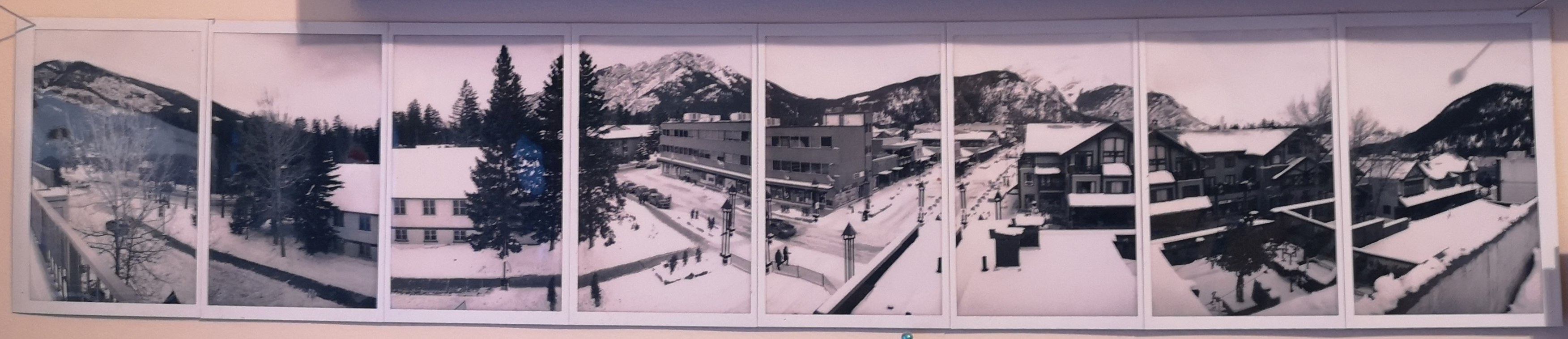

I've taken landscapes, buildings, nature, lots of test shots, and have a bunch of pictures stacked on my shelf or stored in boxes. The pictures don't seem to scan well, so I think they're really meant to look at by flipping through. Actually, I did a panorama which I manually stitched together of Banff that hangs on my wall...
