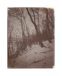

Hmm you don't exactly print a salted paper print, plus it sort of develops itself so I'm not sure if this belongs here ... anyway, my first "successful" attempt ... some sizing and coating skills still to be learned :smile: Plus too much texture in the paper for my taste really.
About 90mins exposure, using a nice dense 5x4 pinhole negative on Fomapan 200 - a snow scene from a few winters ago ...

Nice.. that's a good picture for a salt print! I've got one sitting in toner right this second. This is definitely my latest obsession.. I love making these. The coating gets easier with practice ( and you don't need to do it under a dim safelight... make sure you can see the shiny surface so that you can see any place that was missed... I close the curtains and coat right at my desk in front of the window with the filtered daylight.. no problems with fogging. ) Did you use any citric acid in the salting solution or in the sensitizing silver solution?
wow pdeeh that is beautiful .. it looks like a dream and most certainly belongs in this thread.

you don't need to do it under a dim safelight... Did you use any citric acid in the salting solution or in the sensitizing silver solution?
I used my bathroom 'cause I have it more or less permanently blacked out now, and I just unscrewed the shade from my safelight which was easily bright enough to work by, but I was hasty and it shows.
Also it's always amazing (which it shouldn't be at my age) that however much I read up on what I'm about to do and think about how I'm going to do it, I still almost always make silly errors the first few times I do something new ... hence my threadette about using DW instead of sensitiser :smile:
(To which can be added, when you finally coat the paper with the right stuff, don't forget not to put it in the frame back to front ...)
I didn't use Citric acid or Sodium citrate in either solution. There's so much that's conflicting in the literature about the whys and wherefores of these additives that I thought I'd stick to the very basics to begin with - gelatin/salt/water for the salting, Silver nitrate/water for the sensitiser. If I could get away without the gelatin I would do but the paper I've got (a friend gave me a pad of Bockingford) is a bit porous.
Anyway, don't want to take the thread off onto an alt-process technical discussion tangent :wink:
its fine by me, tangent away ...
as long as you aren't all congratulating eachother for 6 pages its copacetic
Yep, okay! Just one last comment:smile:. I took your 'keep it simple first' approach to the gelatin for the same reasons, and now am experimenting with differing amounts. But do try adding some CA. I started with 1% then gradually increased it up to 6%, watching the effects on the print at each amount. Now I put 0.5% in the salt solution and vary the amount in the silver depending on the paper. You'll be surprised what a difference it makes in the highlights and it makes the "background fog" go away. It sure is fun, isn't it? Today I'm going out to make more paper negatives for salt printing, and half regret that I'm not staying home to make another print!

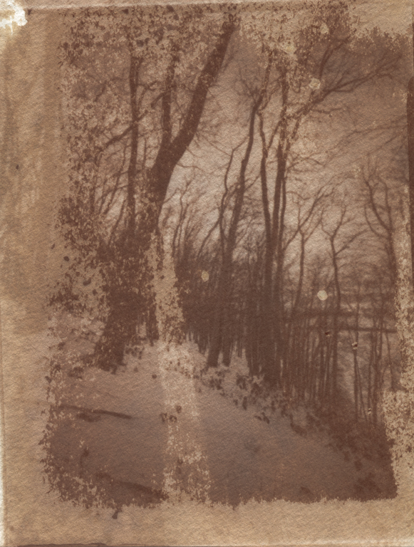

Yet another salt print from the same negative ... different paper, not sized ... this scan doesn't quite get the colour of the original right for some reason (it looks fine in LR but once uploaded or linked loses the richness of the browns) ...
anyway, getting closer ... interestingly, better detail in this than in my digitised version of the same negative :wink:

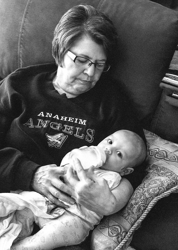

I'm in the process of putting together a darkroom and plan to print it when my paper arrives. Sorry the resolution is so small but I had to take it from the gallery because I don't have the scan with me.
I exposed this at f5.6 for 1 second. It took 7 shots to get one with my grandson staying still for the entire second!

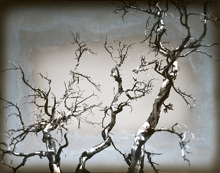

hand full of paper negatives testing out DcaffenolC and Dektol split development
some 4x5, some 35mm ...
