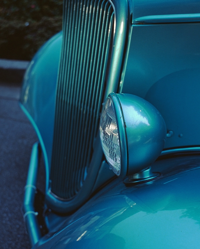

This is from a medium format Ektachrome 100 GX slide - it looks really nice as an 11x14, and could easily go larger. I just wish the downlader here on Photrio disn't force me to resize it so drastically, and did a better job with the small file that results:
