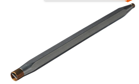

Hasselblad, like any other camera can be broken if instructions are not followed. The Hasselblad rules are easy;
  • Keep the lenses and camera bodies cocked
  • Never remove a lens, extension tube or extender without all items being cocked.
  • Use the recocking tool to recock lenses, which can be used inside the camera body or on the lens directly - https://www.bhphotovideo.com/c/prod...hassy_tool_camerakey_tool_for_hasselblad.html
  • Recocking an unmounted lens
  • Unjamming a Hasselblad http://www.dmin-dmax.fr/photoe2b.htm
  • Add extension tubes or extenders starting closest to the body and add more extenders building out, putting on the lens last. Recock the camera always and then remove each item from the farthest out first and continue removing the farthest out component until all have been removed.
  • Use the recocking tool to recock lenses, which can be used inside the camera body or on the lens directly - https://www.bhphotovideo.com/c/prod...hassy_tool_camerakey_tool_for_hasselblad.html View attachment 350963
Also my Hasselblad repairman recommends that each Hasselblad lens [he recommends this for all lenses regardless of brands] be fired 10 to 15 times a 1 second every three months to keep lenses properly lubricated and avoid lenses jamming. I have been doing this for years and only one very heavily used lens [before I purchased it] needed the shutter shaft replaced. The rest of the lenses function correctly. I mark my calendar to remind me to fire all the lenses on 1 January, 1 April, 1 July and 1 September October every year.
