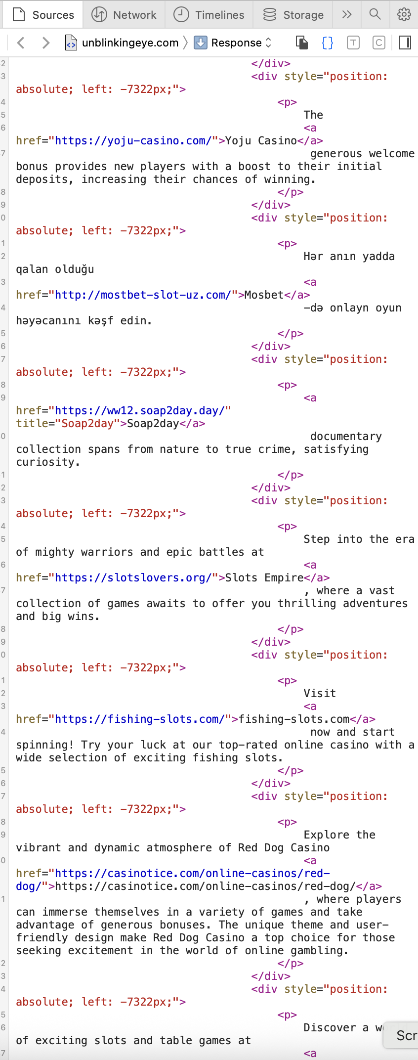

Surely it wouldn't normally be written into the HTML? Or is this actually what you normally get if you use a website builder, or get someone else to do it? (My only experience is of coding my own webpages.)
There is typically waaaay more than HTML driving a modern website. In particular, there is usually a great deal of dependence on third party services to render a page.
What your browser displays is HTML. So whatever you see on your screen is somehow in the HTML that's served to your browser and/or generated dynamically as you're viewing the page. The question is how this HTML is generated. This can be done in a static way as we did in the 1990s, and it's indeed how most of the main content of ublinkingeye was originally made. However, in that static content there's also in this case a number of places where dynamic content is embedded.

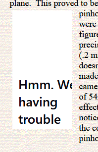

Now, I've paused my adblocker and refreshed the website a number of times and I don't get any gambling ads, but that may be due to the fact that those are illegal presently where I live, so I'm less likely to get that sort of content. Which means I can't reproduce the Russian gambling ads stuff you seem to be seeing, but to give an example, let's have a look at this bit of embedded content:
As you can see, it won't render for me, possibly for the reason indicated above. Let's have a closer look at the white iframe with the error message:
HTML:
<iframe style="width:120px;height:240px;" marginwidth="0" marginheight="0" scrolling="no" frameborder="0" src="//ws-na.amazon-adsystem.com/widgets/q?ServiceVersion=20070822&OneJS=1&Operation=GetAdHtml&MarketPlace=US&source=ac&ref=tf_til&ad_type=product_link&tracking_id=unblinkingeye&marketplace=amazon&region=US&placement=2880467144&asins=2880467144&linkId=bdef1605ce4d0fdbd389490cfc81aec9&show_border=false&link_opens_in_new_window=false&price_color=333333&title_color=0066c0&bg_color=ffffff">
</iframe>
As you can see, this iframe is supposed to populate itself with content from Amazon's ad system. It's possible that in your case, the content renders fine and in that case, it would also pop up in the DOM which you're inspecting using the 'inspect' function (or similar) in your browser.
Well, yes. But the HTML as such really isn't the thing; that's just the stuff that shows up. What happens under the hood is where the complexity is. In part this is client-side processing that happens mostly in JavaScript, which you can trace down and dive into if you have plenty of time. But there's also generally a lot of server-side processing going on; sometimes this results in quasy-static content being served (classic PHP generated server-side, for instance), but today, most websites use 'live' content with the browser continuously interacting through something like e.g. AJAX with a server backend. The frameworks used for this can be exceedingly complex and only a small part is visible to the typical end-user (which of course is by design).
yeah, that's typical of badly-behaved ads on a website that's not very solidly set up/managed to begin with. What essentially happens is that the ad JavaScript that runs on the client machine modifies the HTML that's originally served to the client. Any self-respecting webmaster would report such ads to their ad partner (amazon and/or google in this case) so they would be taken down.
Anyway, we're now in the territory of philosophizing about badly maintained websites and malicious ad systems, exacerbated possibly by weak or missing client-side security. That's a different issue from the connection problems that @pentaxuser reported. For you @snusmumriken the main advice at this point is to ensure that you use a secure browser (e.g. FireFox) that is kept up to date with basic security settings enabled as the browser would by default have.
yeah, that's typical of badly-behaved ads on a website that's not very solidly set up to begin with. What essentially happens is that the ad JavaScript that runs on the client machine modifies the HTML that's originally served to the client. Any self-respecting webmaster would report such ads to their ad partner (amazon and/or google in this case) so they would be taken down.

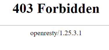

I was doing a bit of research this afternoon and wanted to look at the above site. I tried the link in the site I was on, then tried my own bookmark and finally Googled it Everytime I got the same notice of "403 Forbidden
Has it folded and been removed ? It was sometime ago that I last tried it

I get the same result when I'm using my laptop running Win8, my desktop runs Win11 and it pops right up, no problem.
When you install the last version of Chrome that runs on Win7 and Win8 - which is Chrome 109 - you get this result visiting unblinking eye:
Install firefox.
Windows 7 really doesn't have anything to do with this. Websites in general don't care what OS runs on the machine that the client uses. The risks of an outdated OS are on the client's side, not so much the server's side.
This can sometimes helps if the problem is specifically related to SSL. There's no indication here that this is the case. However, many browsers are now starting to categorically block non-SSL traffic at least on public networks.
Thanks koraks What you have said in the first part of your quote above is what I had intuitively thought So if it unlikely to be Win7 that is causing the problem what might it be and what might I try to fix it?
Is it now more likely to be the use of Google which no longer gives support for Win7 as others have suggested or something else

I tried this or so I think but typing in the address leaving out the "s" and entering takes me to the https which of course give me the 403 Forbidden
It seems that I cannot alter the address and get other than its https address
Maybe I am not doing it right?

Hi @pentaxuser I would suggest you drop an email to the webmaster of the site. Let him/her know what you're error message is when you try to access the page. On the bottom of one of the webpages (the About page) is this link: webmaster@unblinkingeye.com Hope this helps,
Thanks but is the link to which you refer within the unblinkingeye website so that I have to get into the site to one of its pages ( the About page) in order to contact the webmaster? If so, I cannot open the site which is of course the nub of the problem
If as a complete internet ignoramus I have misunderstood what you have said, can you xeplain as simply as possible how I contact the webmaster?
