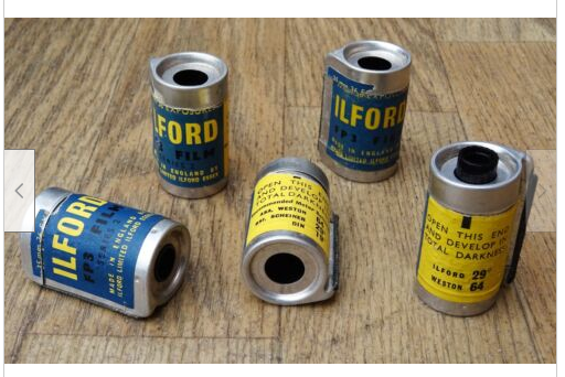

back when ILFORD sold film in Alumium cassettes, the entire cassette was actually lined with a felt like material. you are right that many current ones use a cloth similar to Velour. just like Camera light seals are called "Felt" even if some are made of Black yarn.
Concerning Felt, you North-Americans got your own terminology...
"back when ILFORD sold film in Alumium cassettes"
You are speaking of cassettes in the current meaning applied here at Apug?
I mean aluminium cassettes would very likely deform at relaoding, unless the metal sheet would be substanially thicker than the steel ones. And I got Ilford ones from 60's and they seem metal-wise same as those from the 70's. But I know you are very knowledgable on cassettes and canisters.
yes, when I got my first rolls of ILFORD FP3 they came in an aluminum cassette with Drawn aluminum end caps and the end caps were held on by a paper label. this would have been early 1960s. when I went back to get another roll a month later, they were the steel ones similar to those that AGFA was using at the time.
to reload those OLD ilford cassettes you had to use some sort of tape to hold the caps in place. (replacing the original label)
Ahah, ebay to the rescue https://www.ebay.ca/itm/185668026651

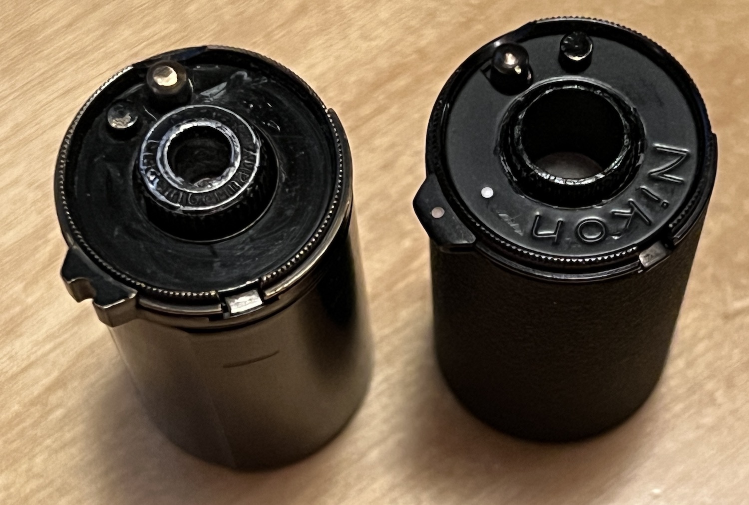

Zeiss cassettes also fit Nikon rf and F cameras.
Interesting proposal! Worth checking. Results: Zeiss Contax RF reloadable cassettes can fit in Nikon F (sorry no any Nikon RFs here to check) but it's impossible to close properly back of the camera. When measured height between 4 Zeiss (49.28; 49.12; 48.85; 48.65 mm) and Nikon (47.32mm) cassette there is ~1 to 2mm difference. Interestingly there is "opening" in the Nikon F body to accommodate protruding lip for proper alignment of both cassettes. Never noticed it before.
My favorite reloadable metal cassette were made by Fujifilm. Bought bunch of them in Japan around year 2000. They are no longer available as far as I was able to check. From my experience ~20 loadings are the max I was able to extract from most of them. Konica cassettes used for their C41 films were excellent quality before they switched to cramped ones.
Thank you for checking and resolving question. Never heard that Zeiss could be used in Nikons, until this thread. Shall continue Zeiss with Zeiss and Leitz with Leica.
