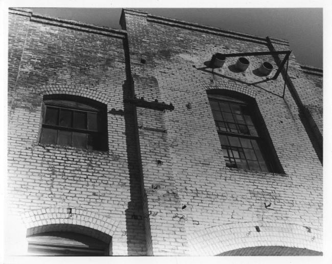

I am fairly new to printing. I have a few prints that have bright white areas with no detail in certain areas. It is not a light leak. Looking at the negative on the light table I can see detail in the bricks there. It just did not get captured by the paper. Maybe the negative has too much range for the paper to capture? What the best way to fix this? Maybe burning that area or maybe printing with a lower contrast grade filter?
Printed on a Beseler 45 - 8x10 enlargement - No filters
Aristra Private reserve RC paper VC
35mm Fuji Neopan 400 film
Film developed with Kodak D76 1:1
Paper developed with Claton P20 developer 1:7

No - there's a deeper problem. Certainly not a problem with dynamic range of neg/paper/film etc... since the edges are very different from the center... LOOKS SORT OF like fogging... but it's kind of hard to tell - if It weren't 35mm I'd suggest maybe you're using a wrong or misaligned lens... you might also want to check to see if your enlarging lens is properly mounted and not spewing light...

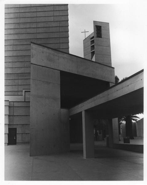

Another print same roll. printed just a few minutes later
Here is another print I made just a few minutes later. Same roll of fim. Same pack of paper etc. It looks fine to me.

looks like exactly the same problem... it's just that the darker tonality of the subject masks it a little.

Kind of looks like a film development problem to me , like the edges might be over developed, which may happen with inadequate agitation. Is this the only roll you have gotten this result ?

Check that your safelights are safe and that you have no major light leaks in your darkroom. If your using a beseler 45, which i assume has the typical condenser head on it, make sure that it is raised to the level of 35mm (the light source as far away from the negative as the adjustment allows). This looks to me that its a problem with film development. Looks like bad agitation methods to me. definitely scan the negs for us, so we can tell you if thats the problem or not. Also, just feedback on your printing. the first one has a bit too much contrast, and is a little dark, bring the contrast down a grade, and give it a little less exposure with the enlarger, and your there!

First thing I would look for is to make sure your condenser head is adjusted for the proper format height. Appears to me you have a hot-spot. What lens are you using, and what condenser setting?

Yes this is the problem,
the negative is not centered under the lens, and condensors or the condensors are in the wrong position for the negative or wrong lens is being used for the negative format.

Vingnetting on camera would be negative density on the film which would be then plus density on the prints.
Negative density on edges of the print is certainly a enlarger problem set up.

I believe that this can have two sources:
1. Like Bob, Tom, and Rick I think that you are either using the wrong condenser for your lens, or some other setup with your enlarger is wrong.
2. It can also be over-developed edges of the film, which is due to insufficient agitation.
It could be BOTH of these.
Do a contact print of your negatives. That will tell you if there is a problem with your negatives or not. If you can tell that you have perfectly even density in your negatives - work on setting up the enlarger correctly.
If you are having problems with the negatives, visible in the contact sheet, you need to address that issue first, before you think of working on the enlarger.

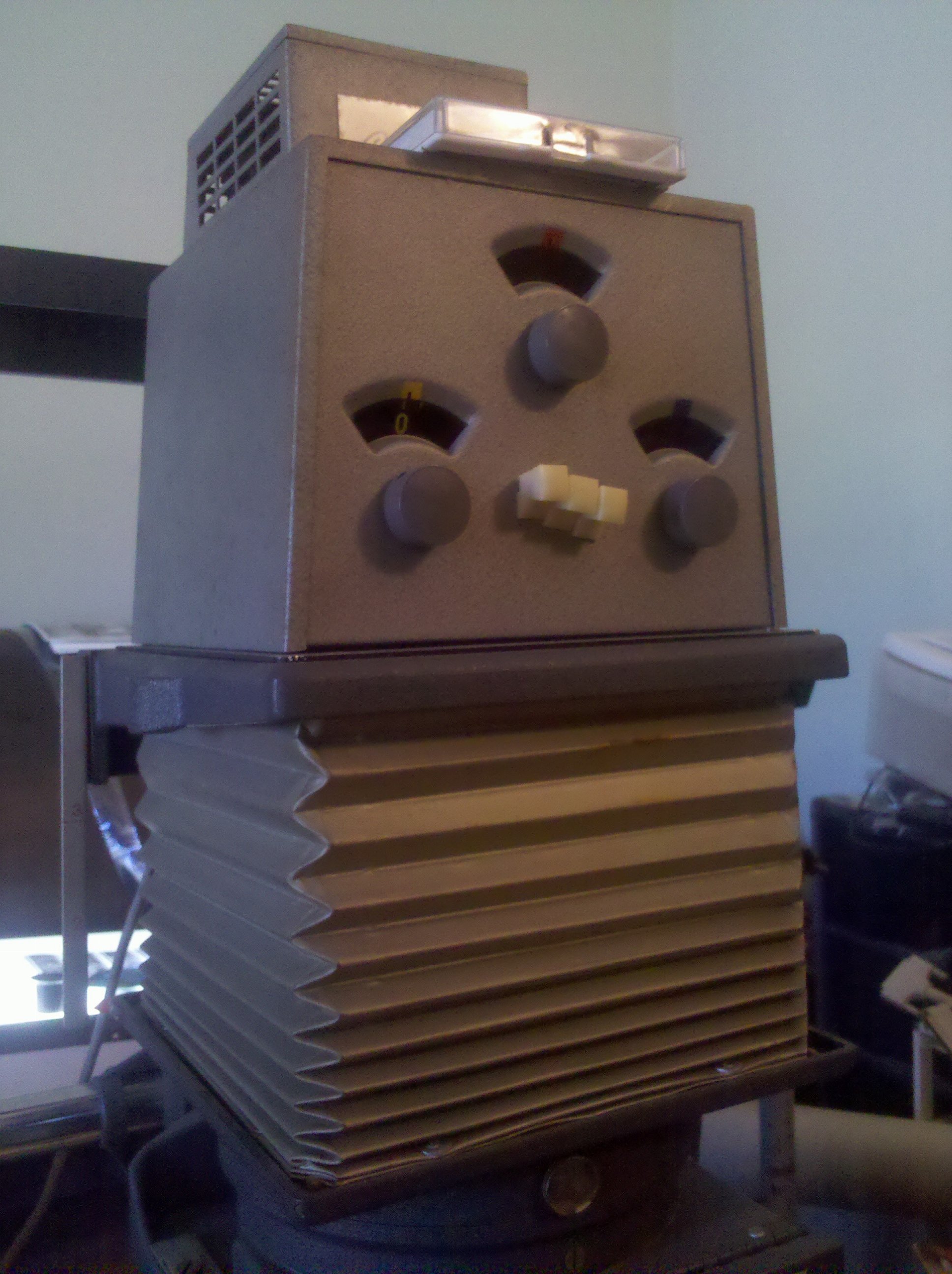

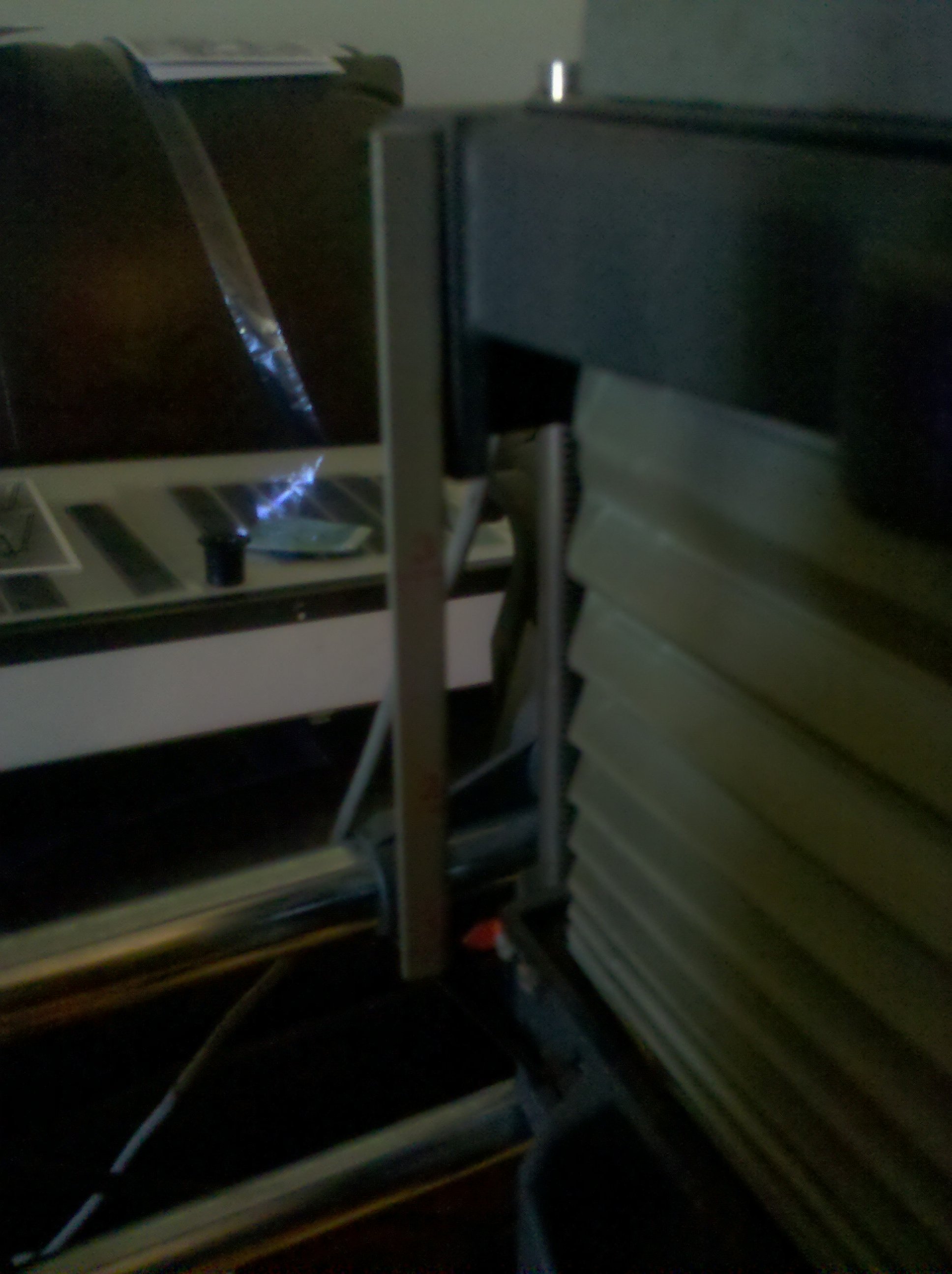

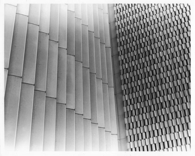

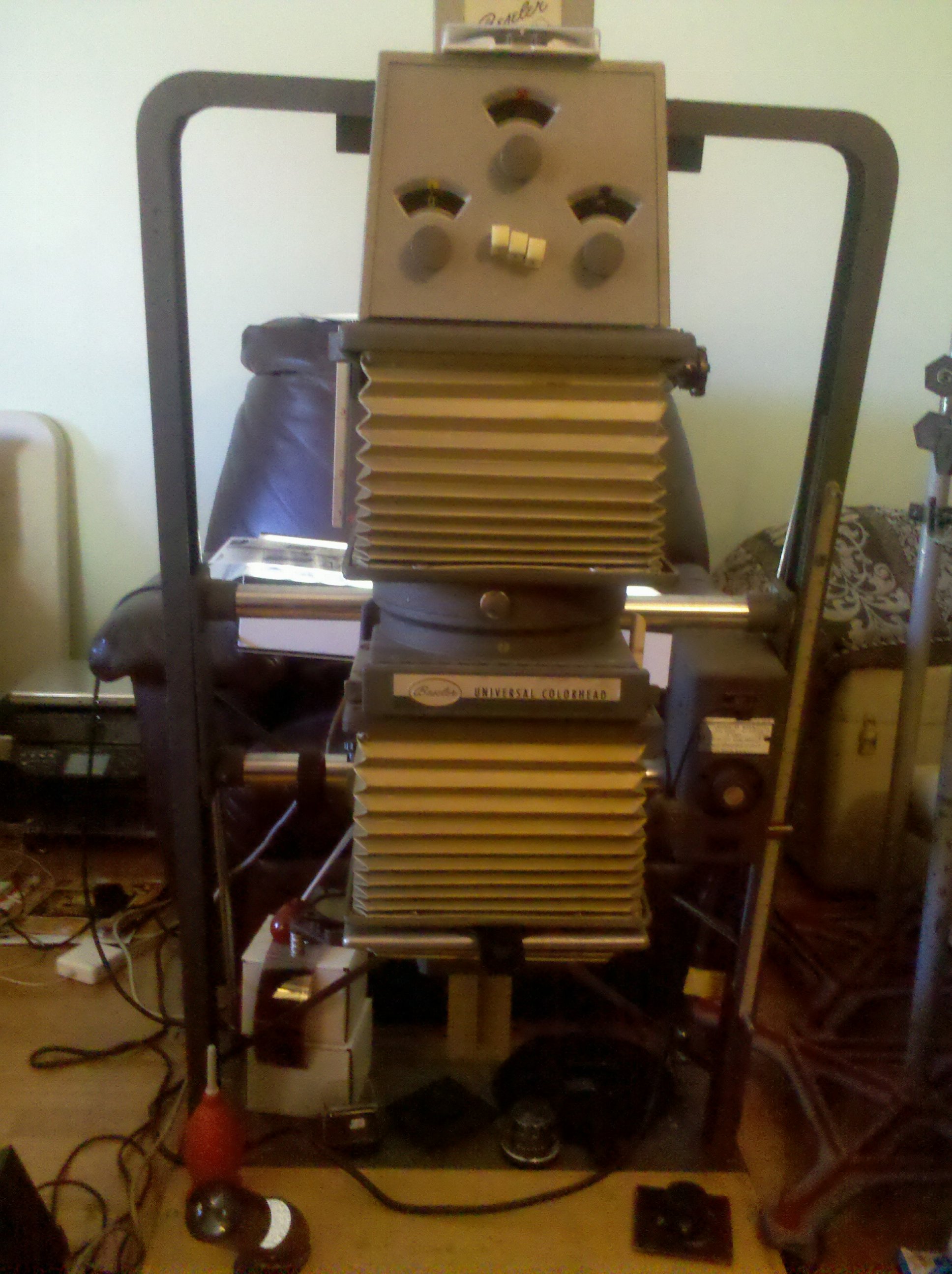

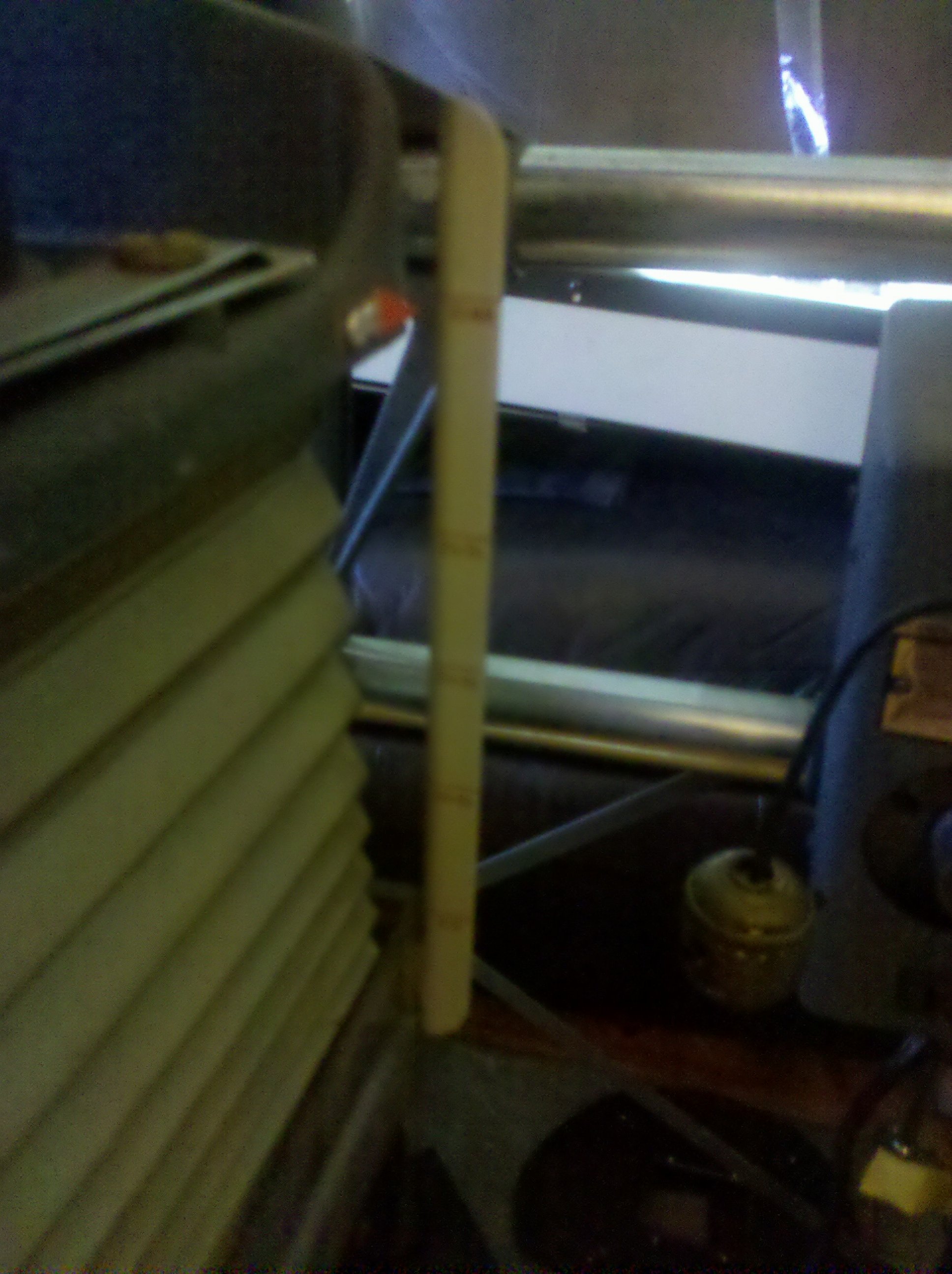

Details about my enlarger setup
If I had to guess I would say that there is some sort of light fall off problem with the enlarger. I can not see the fall off in the negatives on the light table. I can not see it on the easel before I print. I will scan some negatives so you guys can take a look.
Its possible that I have the enlarger setup wrong or it may be dust or dirt in the light house causing the problem. I have not taken the light house apart to make sure everything is clean in there. The lens I am using is a Minolta Rokkor 50mm 5.6. The example prints you see are printed at f8 to f11. The light house is made for color printing. Its a Besler/Agfa brand. It also has a bellows with a index on the side. When printing 35mm I have the bottom bellows set at 35mm and the top bellows set to "1" which is bellows fully extended farthest away from the lens. You can see my setup in the attached pictures.
I have also included a scan of another print that my illustrate the falloff better.

I haven't used that exact setup - but it looks to me as though the condenser is WAY too far away from the light source! You need to decrease the distance between the light source and consdenser. That should fix things.

I am not sure how the top bellows should be set. I do print 35mm, 6x7 and 4x5 negatives. Do I need to change the top bellows whenever I change the bottom ones?
I have not been able to find any documentation on this color head.

There should not be any condensers in that set-up, only a diffuser chamber. The lamp housing should be set at lowest position for dichroic head, no matter which format.
If its suposed to be at the lowest position (bellows fully collapsed) for all formats then what is the purpose for this adjustment?
Rick A
Mar 31, 2009
10,038
Laurel Highlands
8x10 Format
That is for condenser set-up only, not for dichroic set-up, at least thats how my 23C's work. You remove the condenser set, insert the diffuser in its place, run the lamp housing to its lowest position, and install the dichroic head. Oh, and remove the adjusting knob from the lamp house, its not needed anymore.
