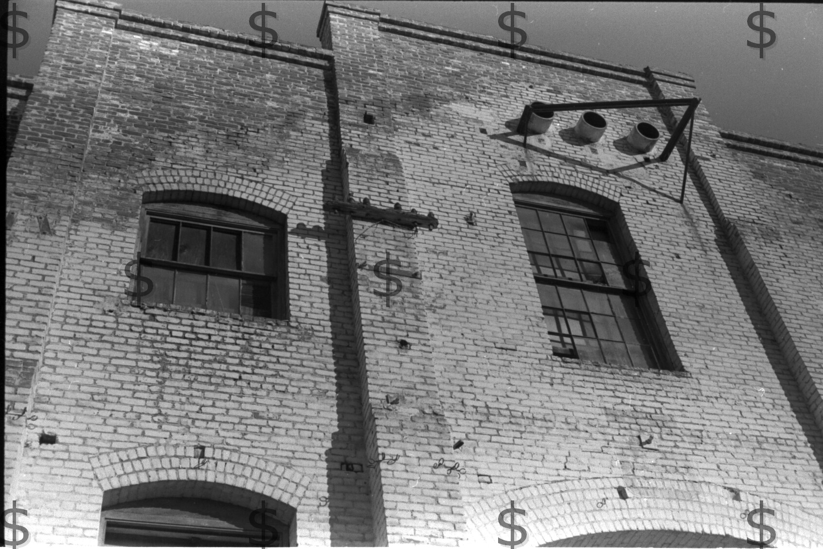

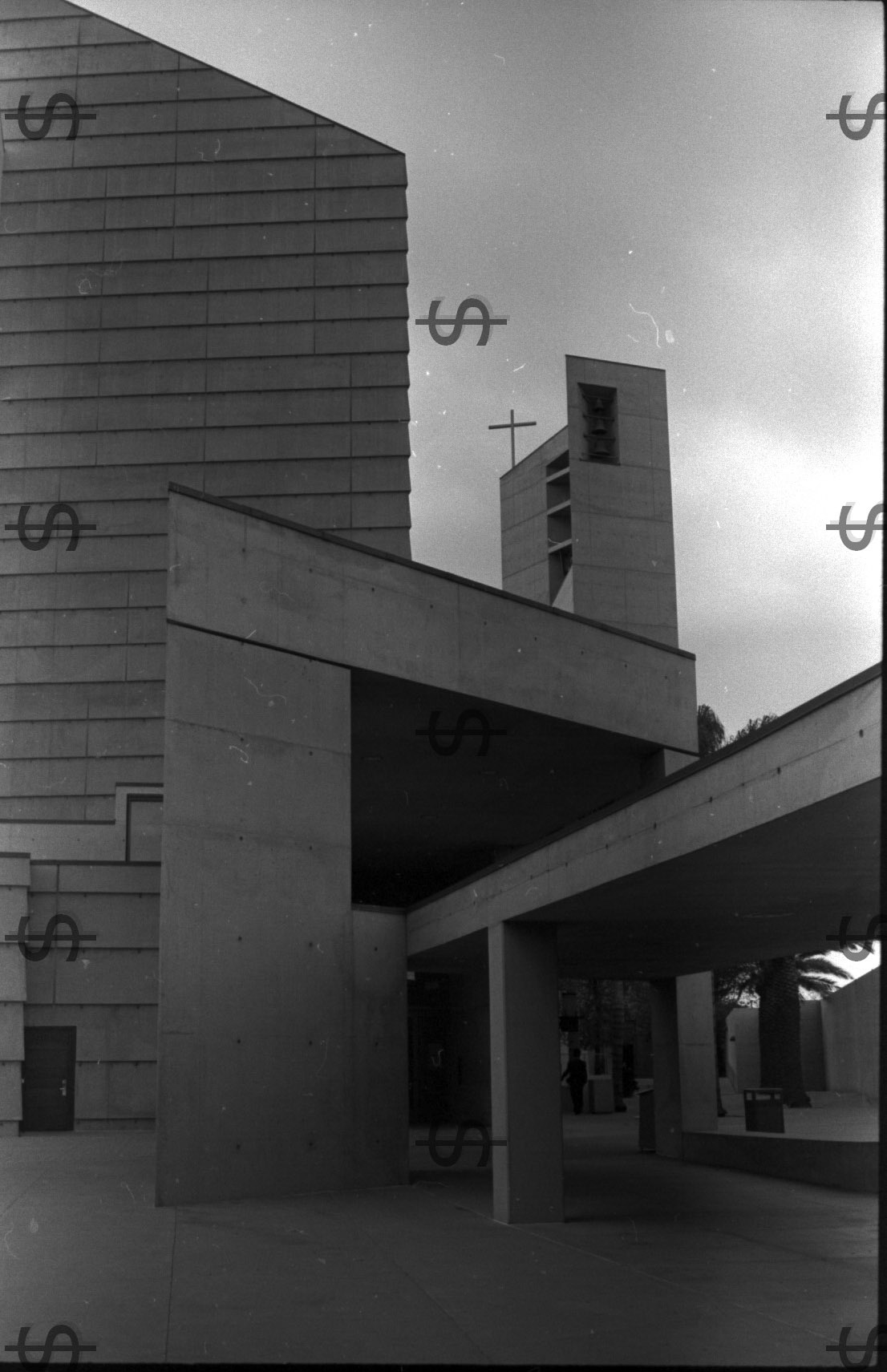

Here are the scans of the negatives
Here are the scans of the negatives. They certainly do not look as bad as the prints. I am having a hard time deciding if there is any problem with the negatives. They look like what I shot. I think the light areas are because of the way the light was in the scene. What do you guys think?
Excuse the dust. The dollar signs are because I have a trial copy of Vuescan.
My developing tank is one with plastic reels. It has a shaft that connects to the reel column with a knob on the outside that allow you to rotate the reels inside the tank. There is also a cam on the bottom of the tank that raises and lowers the reels during the rotation. My agitation is 5 one seconds cycles of the knob (back and forth on one cam lobe) every 30 second about a quarter turn in each direction. I do this the whole development time.

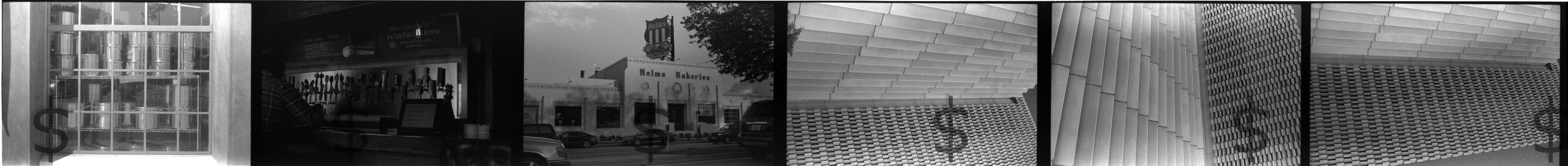

Here is a strip of negatives scanned
Scanned a strip of negatives:

From the scans we can tell that you have much higher density on one sides of the negatives. In the second frame from the right, on the strip you scanned and posted, it is clearly visible.
When you develop film, instead of using the spinner, completely invert the tank instead. If your tank leaks, get another one. The spinner is simply not a good way to agitate. Dev tanks are inexpensive these days, and a good one would allow you to agitate correctly.
You want about two full inversions in that 5s every 30s. As you completely invert the tank, you also rotate the tank around its center core, so that in two inversions, you will also have rotated the tank at least one full 360 degree rotation. (Basically just grab the tank by the top, and rotate it with one hand while you invert the tank).
You may still have a problem with the enlarger. But you simply must address this problem with your agitation, to get evenly developed negatives, before you can tell whether your enlarger is correctly set up or not.

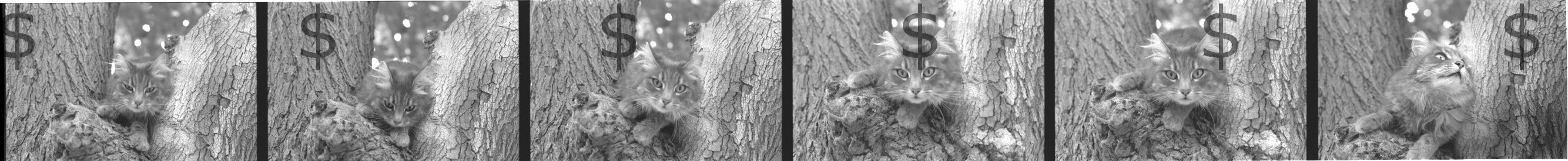

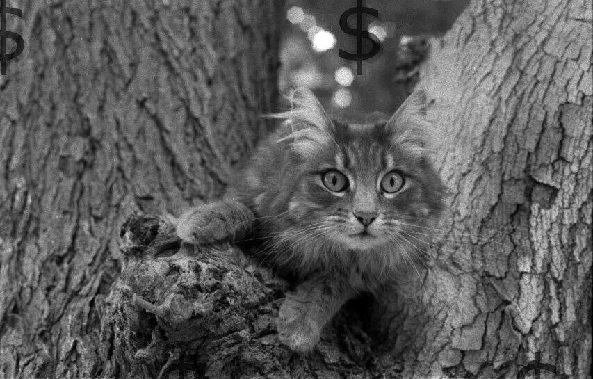

Roll developed with the inversion method of agitation
Here is a scan of a strip of negatives from the roll I deveoped last night. I noticed that the density of the negatives has increased compared to the spinny rod agitation method. I see this in both the negatives and the exposed portion of the leader.
These look even to me. The focus is a little soft but that is due to a moving cat or me not focusing accurately. Cats are hard to take pictures of because they move so much.

Negs look ok on edges, now print with your setup and see if there is fall off on edgeson print due to enlarger set up.
They look even to me too. The increased density comes from agitating more, which brings more active developer to the film plane (as it should be). To compensate for this, you just develop for less amount of time. Easy peasy. :smile:
And, as Bob says, now it's time to examine what happens when you print negs that we know are good.

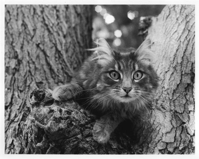

Made a print
Here is a scan of a 8x10 print I made. I also included a scan of the negative. Here are the details:
Negative:
Fuji Neopan 400
Nikon FE
Nikkor 50mm f1.4
Exposure: 1/125 at f4
Developer: Kodak D76 1:1
Print:
Aristra Private Reserve RC VC
Beseler 45 Enlarger
Lens: Minolta Rokkor 50mm f5.6
Light house bellows set to "2" (half way extended)
Condenser bellows set to 35mm
No filters - grade 2
Exposure: 20 seconds at f8
Developer: Clayton P20 1:7
The one with the white border is the print. What do you guys think?

Jan 21, 2003
15,715
Switzerland
Congratulations, you solved your problem. Well done!
