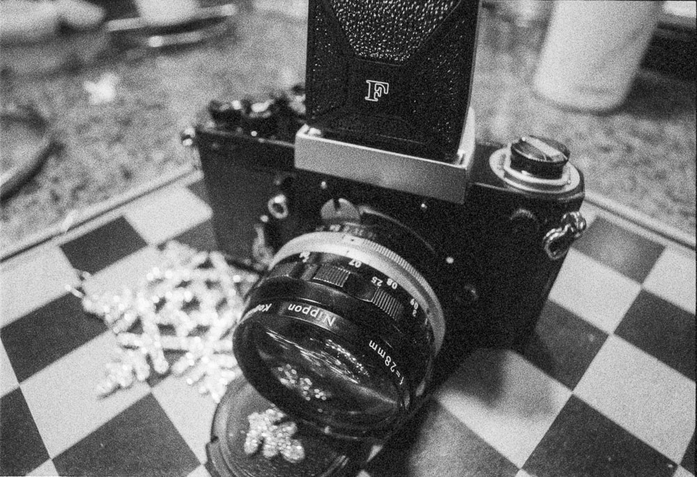

Your scans looks like severe over sharpening or something.
It looks ruined, sorry.
Also, if you scan it is easy to get any amount of contrast in PP.
All the real difference is fast or slow film. Summer time - go crazy and try ISO 25, winter time - push 400 @1600.
But you really need to sort out quality loss first.
This is crapiest film I have tried "new" TMAX3200 @6400. Plustek 8200i scan:
I think that was a problem with Lightroom export and sharpening for screens something like that was activated and in high setting. The scans looks OK to me in my screen, but in my city there is only one scaning lab so i have no other choice, they use a Noritsu LS 1200 i think.
