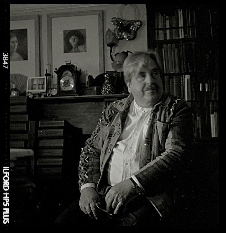

Another thing to consider is the lenses. Quite a lot of the images taken you looked at were taken on uncoated pre-war Leica lenses or possibly lenses like the post war Elmar with simple coatings. Those type of simple lenses with early or no coatings had a certain look that was down mainly to flare compressing tones making the shadows seem to have detail.
If you take an early lens design say an Elmar or Tessar and use Tri-x/HP5 or FP4/Adox 100 you'll get a similar look and feel.
I like the low light gritty look Brassaï obtained and can get that with HP5+ or even Delta 3200 using medium format.
The above is a 1950's Tessar HP5 in Rodinal
Seems to suggest earlier times to me...
