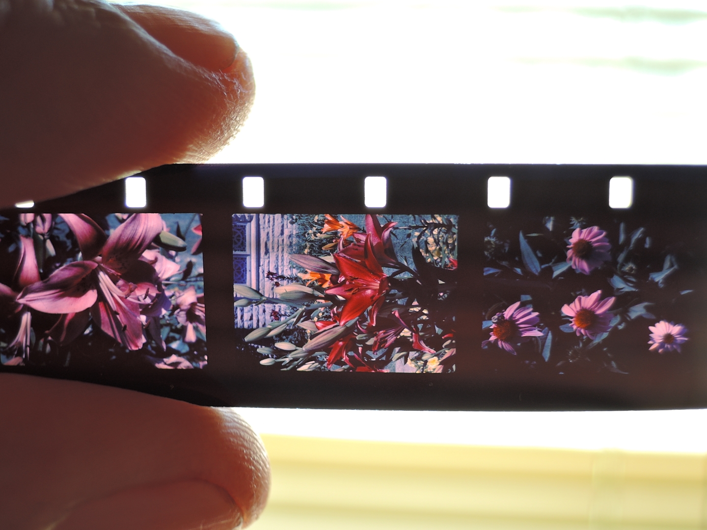

Don't you have to add contrast and saturation to this Cine type of film to make it more appealing for most viewers?
When developed as a negative, yes. When cross-processed as a positive you get the opposite effect -- high contrast and saturation.

Whoa.........how do you process as a positive? I mean, sure, I get the hypothetical. But not the real world.
That strip is 500T with 1-2 stops overexposure seeming to give the best slides / reversal results.
E6 times & temps: remove remjet, D-19 1st developer, stop bath & re-expose to room light, ECP-2 2nd/color developer, bleach & fix.
The presence of an orange mask in the film precludes the 'more perfect' color fidelity you'd see from ektachrome/provia but the extra blue response from shooting unfiltered in daylight seems to offset that at least a little. I've attempted this processing regime exactly one time so YMMV. Dynamic range does seem to suffer with this process versus intended use as a negative but that's what you'd expect from a slide film.
Wow! Gotta hand it to you. Too bad there's that mask.
