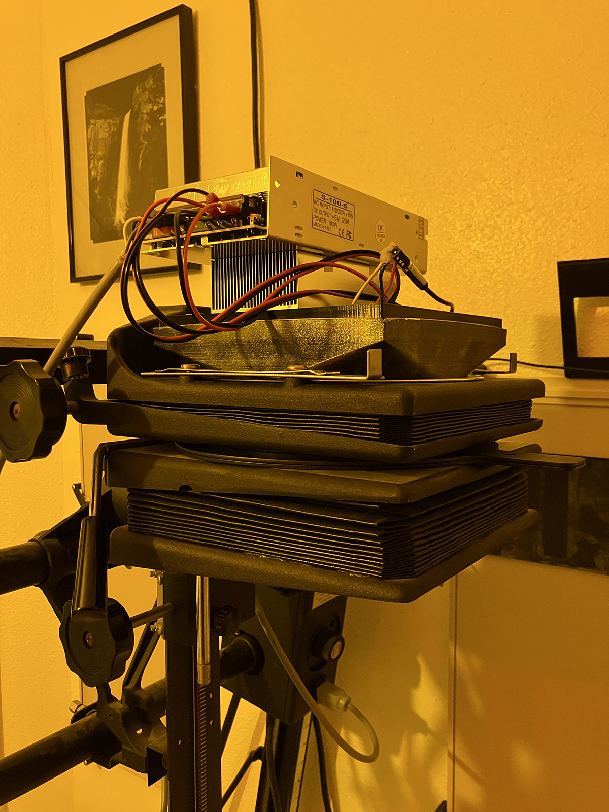

Forgive the yellowness, I use a bug light as my "main" light in the darkroom and leave only the red lights on when I'm not doing alt processes that can handle the yellow. There's no "proper" light source in the room anywhere haha.
First shot is the head. It leans hard into the "Borg" aesthetic. From bottom to top you can see the bellows, the head itself (black 3D printed bit sitting on top of the top bellows), then a big ol' heatsink, and finally the power supply unit on top of that. It uses 256 neopixel LEDs and a diffuser plate cannibalized from a Zone VI cold light head.

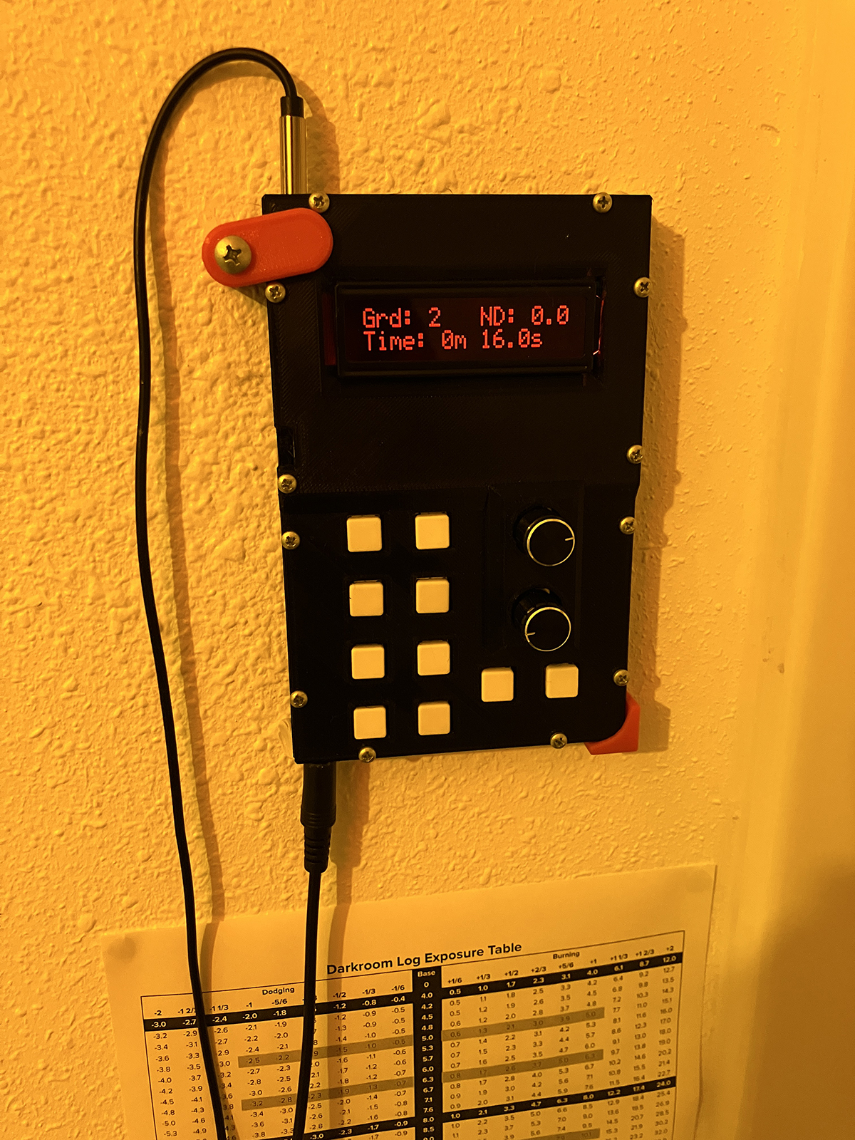

Second picture is the custom control panel. It runs on a Pico RP2040 microcontroller that I programmed in CircuitPython. The cord coming into the top is power from the power supply as well as data out for actually controlling the lights. The cord on the bottom goes to my foot pedal. Buttons are for controlling exposure time (in minutes, seconds, stops, or 1/12 stops), the two on the right are for activating compose/focus mode (all LEDs at 100% brightness on R, G, and B channels), and the far right button is the same as the foot pedal, just a "start exposure" button. Top knob controls contrast grade in 1/2 grade increments from 00 to 5. Bottom knob control "neutral density" (really just selective dimming of LEDs) in 1/3 stops from 0 to 5 stops.
It was a really fun project to put together, and it's a real joy to use. So much easier than messing around with that heavy condenser head and giant filters in and out of the tray.

Nice. I admire your electronics and programming skills. It does look a bit sci-fi. :smile:

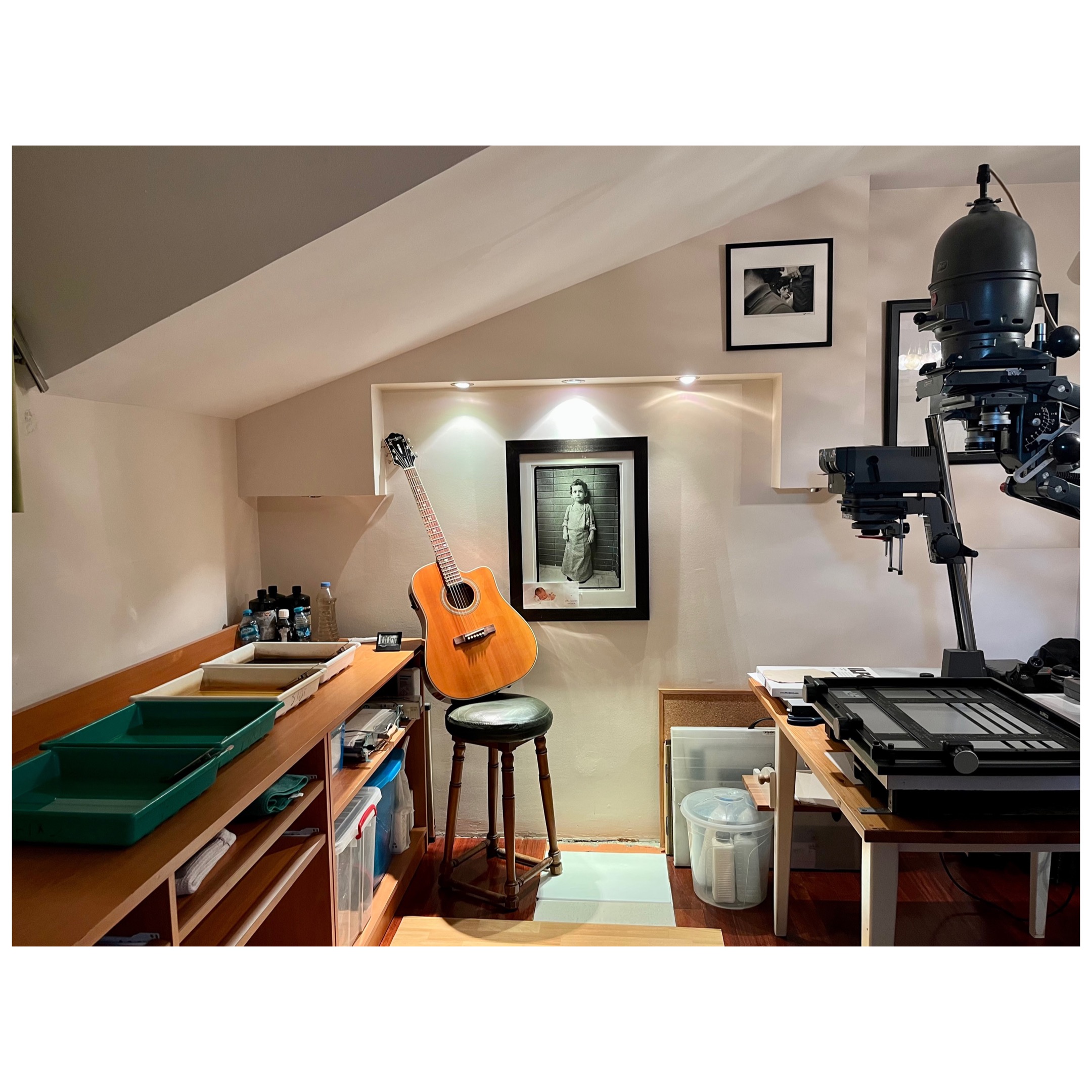

Like a lot of impoverished Europeans, I own a Meopta Opemus. It's good for up to 6x6 and is fitted with the corresponding colour head. Wish my daughter would clear enough rubbish out of my "darkroom" to enable me to use it. It uses a pair of Minolta CE's - a 50mm f2.8 and an 80 mm f5.6
