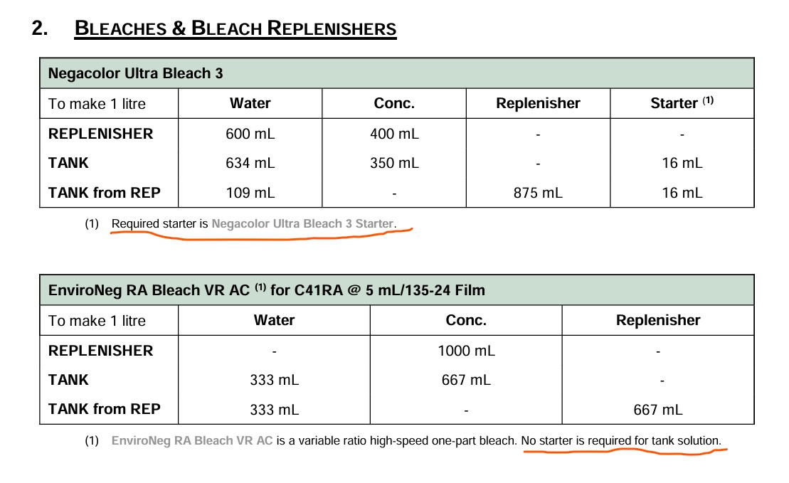

Whether or not a starter is required depends on the formula itself. Here's how Fuji's chemistry works:

foc
Jun 30, 2010
2,568
Sligo, Ireland
Many years ago I had to mix fresh tank of C41 Bleach from Fuji CN 16s chemicals cartridge and Fuji had no Bleach starter.
Worked just find. Just like the time the film processor Bleach heater failed and I had to wait 5 days for a replacement. Bleach tank worked at 31C with improvised heater, again not ideal but very workable.
