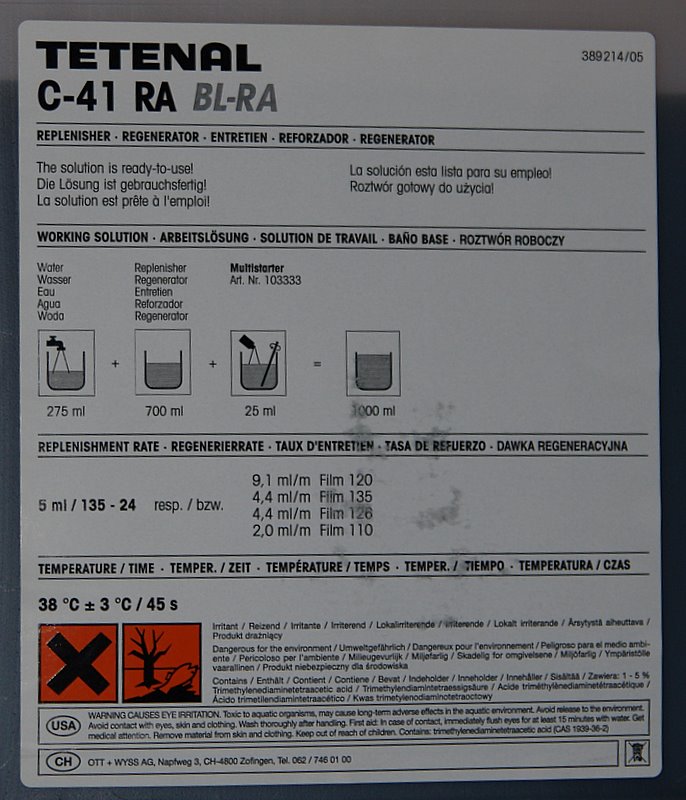

Basically, bleach starter for a color process is nearly an oxymoron. You do not need a bleach starter, a fix starter or a final rinse starter.
PE
Hm, how would I use this solution as bleach then?
Photo Engineer
Apr 19, 2005
29,033
Rochester, NY
I hope so. IDK what Tetenal supplies as bleach. I know what Kodak and Fuji supply. I know that the bleaching process goes to completion and does not need a starter.
PE
