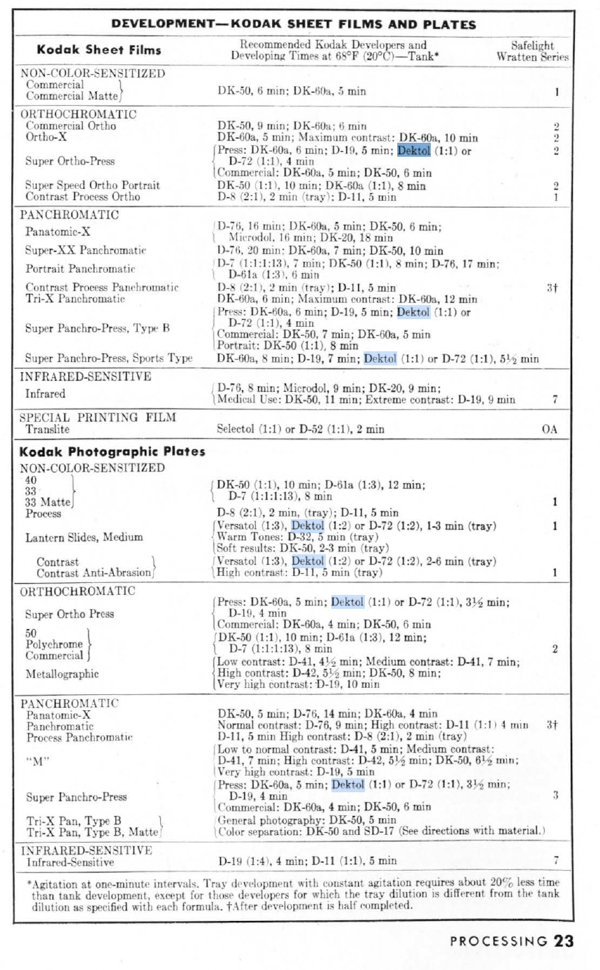

For the sake of argument, let's mention that Dektol/D-72 was a "universal" developer that was meant to be used with both films and papers. Of course, it was mostly recommended for sheet film because of graininess, but it worked and Kodak gave times for it.
Not sure if it's still a good choice on modern films and smaller sizes, though.
Here's an excerpt from the 1946 Reference Handbook.
