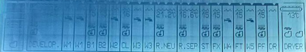

@isaac7: these are the steps in Dr5 process:
Source:
Note the temperature of R.SEP (sepia developer). It is 16.6 C and not 60 C. Rules out hypo-alum sepia toning as speculated by some.
Also note there is a step ST that's done after second development but before fixing as opposed to step FT which is done after fixing. These could be some intensification steps. Or is ST a stop bath as you mentioned earlier? And FT is formalin treatment? Which means there is no intensification at all. 😅
Excellent !
So, it is apparently:
1. First developer
2. Two washes
3. Bleach 1
4. Bleach 2
5. Wash
6. CL = most likely clearing bath
7. Two washes
8. R. NEU = ??
9. R. SEP = ??
Steps 8 and 9 must be some kind of second developers, otherwise the image can't be produced.
Also, temperature for step 9 is unusually low, 16.6 C.
Maybe only one of 8 or 9 is active at a given time.
10. ST = stabilizer, i guess (?) or "special treatment"
11. Fixer
12. Wash
13. FT = can be "formaldehyde treatment"? "final treatment"?
15. Wash
15. PF = most likely Photoflo
16. Drying
Source:
I appreciate the image, I really didn't want to sign into IG lol. Interesting that the sepia developer is so low. I assume there is a stop after the second developer though I'm not sure why it would be abbreviated ST.

Yeah #8 is the neutral 2nd developer #9 is the sepia 2nd developer. It's possible that the developer in #9 wasn't being used when this picture was taken. Film would only be put through #8 or #9 not both. There were frequently delays if you wanted that warm tone developer as he would wait to get enough to do a batch. If it really was being run at the higher temperature I understand not wanting it cranked up unless it was needed.

8. R. NEU = ??
9. R. SEP = ??
"R.NEU" = Redeveloper, neutral
"R.SEP" = Redeveloper, sepia
This would be my guess.
That's interesting since it was mentioned earlier that the sepia redevelopment would have been at high temperature. It's possible that the thermostat for that bath was hacked/modified.
"Stop". See earlier discussion on the need to instantly stop development for archival purposes.
