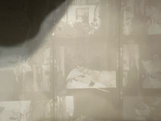

Hello.
The negatives were shot on a Pentax 645, on Ilford Delta 400, 120 film. If anyone is curious.
I am using Ilford MGRC, Multigrade RC, Deluxe Pearl, print paper.
For chemistry, I am using Ilford rapid fixer, Ilford Ilfostop, and Ilford PQ universal developer for print and film.
For all steps, I use constant agitation and a temperature of 68°F. First, the developer is used for two minutes, then the stop bath is used for 10-20 seconds, and then finally, the fixer for 30 seconds.
My enlarger is a Durst and M605.

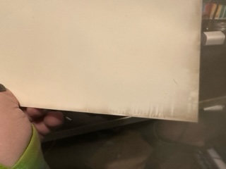

In the second picture, this shows how I began my session. This is with the knob on the front of the enlarger, set to ‘out’. and the lever on the left side, set to ‘out’. After I realized they were incorrectly, set to ‘out’. I switched both of them back to ‘on’ Then I turned the Magenta to 60, Yellow and Cyan are left at zero.
This is when my images began to not appear on the print paper. However, you can see at the very edges a small amount of the image from the negative is showing. I thought initially maybe it was my developer, and that, maybe, it became contaminated. So, I poured the chemicals out, washed the containers, and re-mixed fresh chemicals.
As I said before, I know the chemicals work, because before I switched those knobs, I was getting an image on the paper, just a faint one, because the light was switched to ‘out’, and no magenta was getting through in order to give the image contrast. Anyway, after I changed the chemicals to fresh, there is still no image on the print paper.
So, I am very confused, what could be causing this?

got it I'm going to attempt this, stand by...
Did you set the correct filtration for your chosen contrast? Have you read Ilford's spec sheet for that paper? Have you read the owners manual for your machine? Have you done any test strips to determine exposure times?
yes, yes, yes, and yes. Still fairly new at this ad you guys are always so helpful so here I am :smile:
The pictures you posted are quite small and poorly lit. This makes it hard to tell what we're actually looking at here. For instance, the 'start of session' pic (which appears to be a contact sheet of some sort?) shows a suspicious gradient with a lighter center and darker edges. There also seems to be some kind of striation pattern in the center. All this suggests insufficient development - but it might also be an artifact from a poor photo. Could you provide better photos especially of the first print that showed faint images?
Overall, if an image fails to appear on paper and you know the developer does something, insufficient exposure is the first place to look. What kind of exposure times are you getting?
Also, since we're seeing something that resembles a contact sheet, can you share some info/pics on the contact printing setup you're using?
Can we have a photo of your negatives, photographed against some kind of backlight (light table, computer monitor with a diffusion sheet etc.)?
To verify the functionality of the developer a bit, have you tried processing a strip of paper exposed to room light the same way you're processing your prints? This strip should come out pitch black with no blotchiness, coloration etc. Can you verify this, please?
